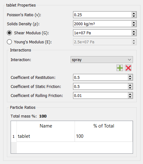

    Figure 5.

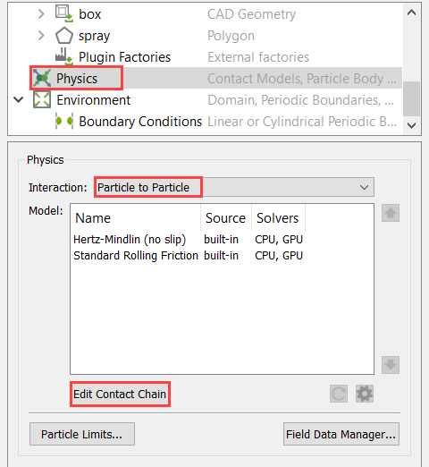

  1. In the Creator Tree, click Physics.
  2. Set the Interaction to Particle to Particle then click Edit Contact Chain.
    Figure 7.

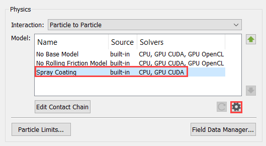

  3. In the dialog, activate the checkbox for the Spray Coating model. Set the Base and Friction models as shown in the figure below and click OK.
    The tutorial is set up in such a way that the tablet particles do not interact with each other. Hence, the base contact models can be turned off for a faster turnaround time.
    Figure 8.
  4. In the Creator Tree, select Spray Coating and then click .

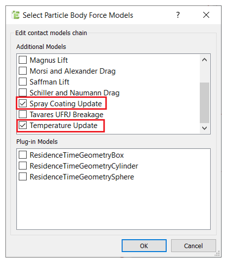

  10. In the Creator Tree, change the interaction to Particle Body Force and then click Edit Contact Chain.
    Note: In this simple example, the tablet particles are created such that there are no tablet-tablet and tablet-geometry contacts. Hence the contact models are turned off to save computational time. The spray-tablet contacts are still active and are handled by the spray coating physics model.

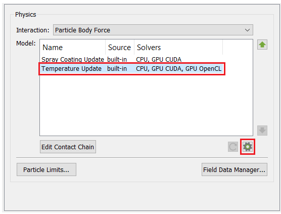

  11. In the dialog, activate the checkboxes for Temperature Update and Spray Coating Update and then click OK.
    Figure 12.
    By including the spray coating model in the particle body force, the target material’s volume is updated. Without this, only the target material’s Volume Added property will increase.
  12. In the Creator Tree, select Temperature Update and then click .

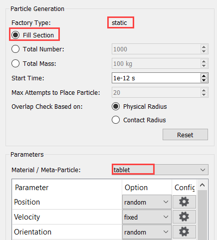

  2. Right-click box and select Add Factory > Add Static Factory.
    Figure 14.
  3. Set the particle generation parameters as shown in the figure below. Make sure that the Material/Meta-Particle is set to tablet.

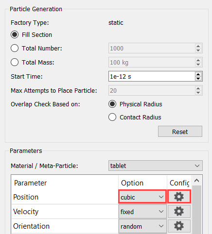

  4. Under Parameters, set the Position option to cubic and then click .

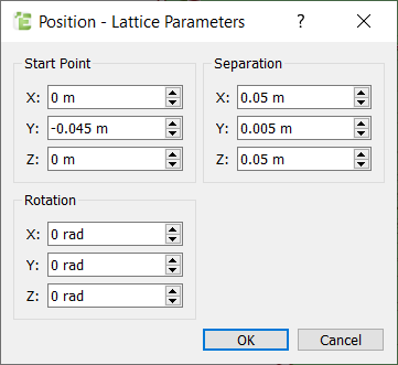

    Figure 16.
  5. In the dialog, enter the position parameters as shown in the figure below and then click OK.
    This creates a row of tablet particles spaced evenly along the y-axis and located at the center of the box.

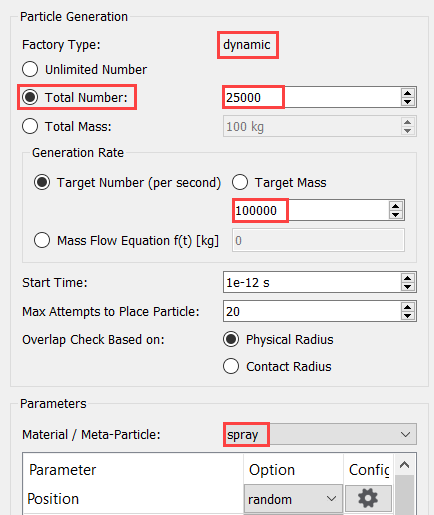

  8. Right-click spray and select Add Factory > Add Dynamic Factory.
  9. Set the particle generation parameters as shown in the figure below. Set the Material to spray.
    Figure 18.
  10. Under Parameters, set the Velocity option to spray and then click .
