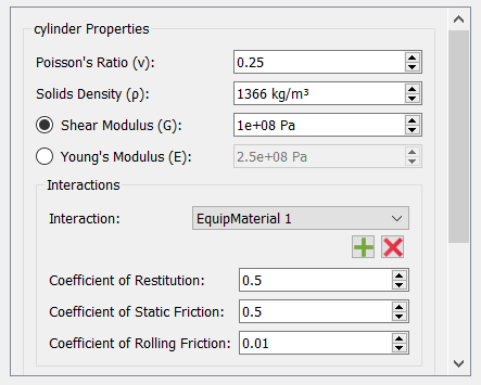

  1. In the Creator Tree, expand Bulk Material > cylinder > New particle 1.
  2. Click cylinder and verify that the properties are set as shown below.

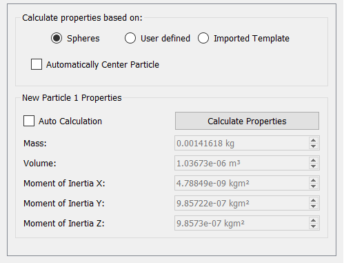

  3. Click Properties under New particle 1.
    Observe that the particle shape is created using multiple spheres aligned along the x-axis.
    Note: When defining non-spherical shapes, you need to make sure that the principal axis of the particle is aligned with the x-axis, as shown in the figure below.
    Figure 6.
    The length (L) and diameter (D) of the particle are 0.05 m and 0.00541 m respectively. Therefore, the aspect ratio (= L/D) of the particle is 9.242.
  4. Observe the mass and volume of the particle in the Creator Tree.
    Figure 7.

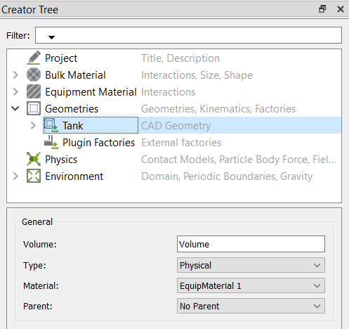

  1. In the Creator Tree, expand Geometries.
  2. Click Tank and verify that the type is set to Physical.
    Figure 8.

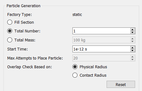

  5. Verify that the Factory Type is set to static and set the particle generation parameters as shown in the figure below.
    Figure 9.

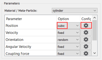

  6. Under Parameters, set the Position option to cubic and click .
    Figure 10.

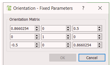

  8. Under Parameters, set the Orientation option to fixed and click .
  9. Enter the values for the orientation matrix as shown in the figure below.
    Figure 12.
  10. Click OK.
