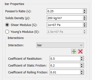

  1. In the Creator Tree, right-click Bulk Material and select Add Bulk Material.
  2. Rename the material to bar.
  3. In the Creator Tree, set the Solids Density property to 200 kg/m3 and the Shear Modulus to 1e7 Pa.
  4. Click below Interaction to define the interaction properties for collisions among the bar shaped particles. In the dialog, click OK.
  5. Set the interaction coefficients as shown in the figure below.

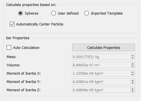

  10. In the Creator Tree, click Calculate Properties.
    Figure 7.
    Note: Since the "Automatically Center Particle" option is active, EDEM will internally adjust the positions of the spheres in the particle. Although you might see minor changes in the location of the spheres, the overall dimensions of the particle stay the same.

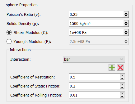

  16. Click again to define the interaction properties for collisions with bar particles. In the dialog, select bar and then click OK.
  17. Set the interaction coefficients as shown in the figure below.
    Figure 9.

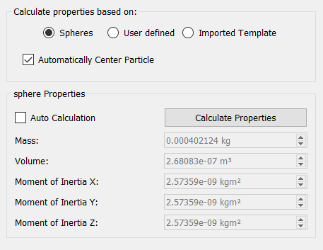

  22. In the Creator Tree, click Calculate Properties.
    Figure 11.

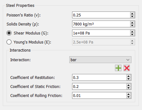

  26. Click below Interaction to define the interaction properties for collisions with bar particles. In the dialog, select bar and then click OK.
  27. Set the interaction coefficients as shown in the figure below.
    Figure 12.

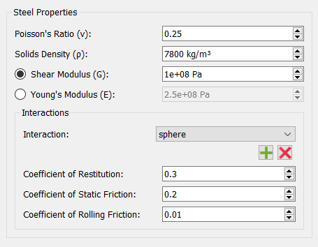

  28. Click again to define the interaction properties for collisions with sphere particles. In the dialog, select sphere and then click OK.
  29. Set the interaction coefficients as shown in the figure below.
    Figure 13.

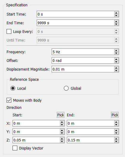

  3. Right-click Sieve and select Add Motion > Add Sinusoidal Translation Kinematic.
  4. Name it oscillation and specify the parameters as shown in the figure below.
    Figure 14.

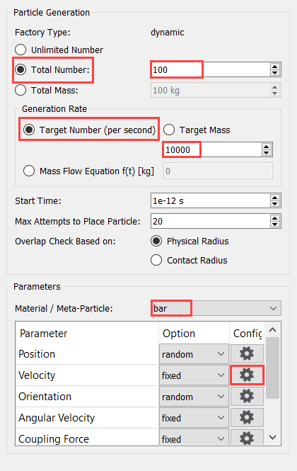

  8. Right-click factory and select Add Factory. Name it bar factory.
  9. Set the particle generation parameters as shown in the figure below.
    Figure 15.
  10. Click besides Velocity, set the Z-velocity to -1 m/s, and then click OK.
  11. Repeat steps 8-10 to create another factory named sphere factory. Use the same parameters but set the Total Number to 200 and the Material to sphere.

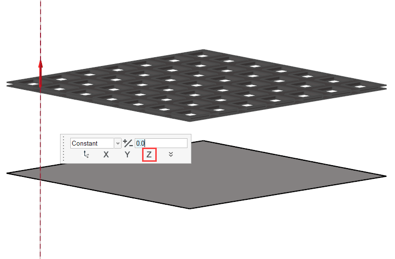

  5. Click Vector on the guide bar.
  6. Click anywhere on the sieve surfaces in the modeling window.
  7. In the microdialog, click Z to align the axis to the global z axis.
    Figure 36.
