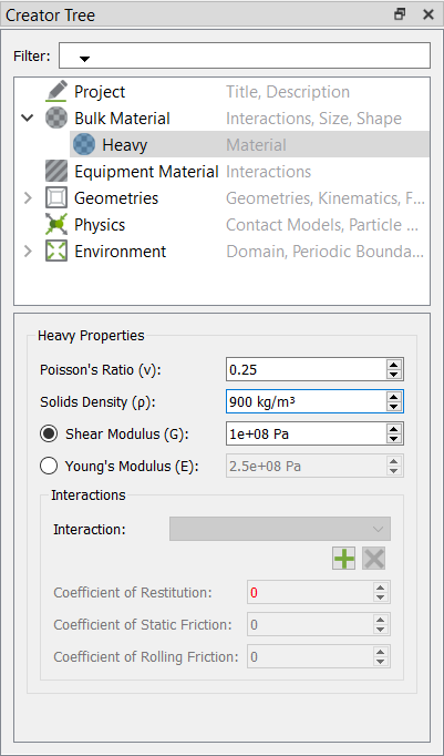

  1. In the Creator Tree, right-click Bulk Material and select Add Bulk Material.
  2. Rename the material to Heavy.
  3. In the Creator Tree, set the Solids Density property to 900 kg/m3.
    You will use the default values for other properties for this tutorial.
    Figure 23.

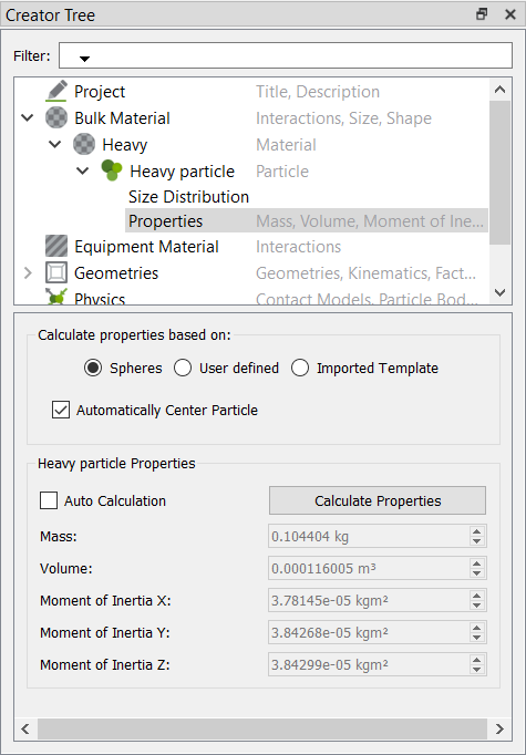

  9. In the Creator Tree, click Calculate Properties.
    Figure 25.

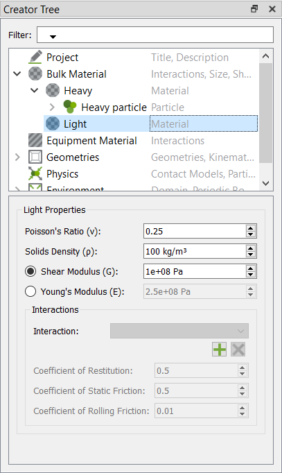

  10. In the Creator Tree, right-click Bulk Material and select Add Bulk Material.
  11. Rename the material to Light.
  12. In the Creator Tree, set the Solids Density property to 100 kg/m3.
    Figure 26.

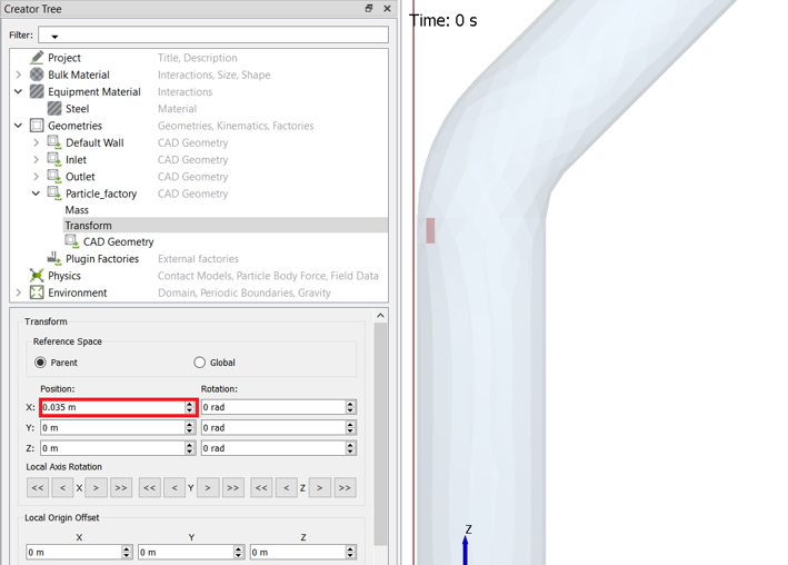

  8. Under Particle_factory, click Transform. Set the X-Position to 0.035 m
    Figure 30.
    Note: Set the Opacity value to 0.2 to see the transformed surface location inside the pipe geometry.
    This is done to make sure that the particles are generated inside the fluid domain.

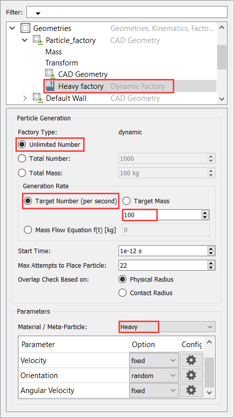

  1. In the Creator Tree, right-click Particle_factory and select Add Factory.
  2. Rename the new factory to Heavy factory.
  3. Set the particle generation parameters as shown in the figure below.
    Figure 31.
  4. Click besides Velocity, set the X-velocity to 1 m/s, and then click OK.

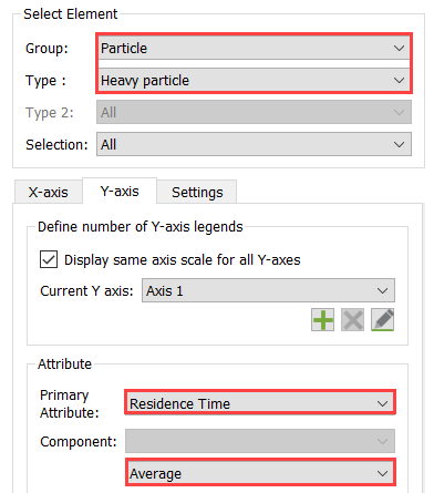

  14. Click the Y-axis tab. Create a plot of average residence time of the heavy particle over the simulation time by setting the values as shown in the figure below.
    Figure 60.

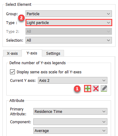

  15. Click to add another Y-axis and set the Type to Light particle.
    Figure 61.
  16. Leave all the other options unchanged and then click Create Graph to create a plot of average residence time of both the particles.
    Figure 62.
    The plot in green is for the heavier particles and it can be observed that the average residence time is higher for the heavier particles compared to the lighter particles (blue).
