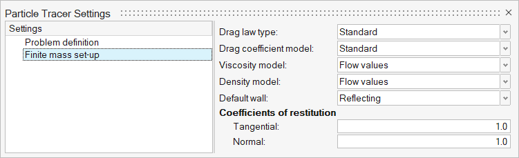

Click Finite mass set-up and leave all the parameters as
shown below.
Figure 40. - Close the dialog.

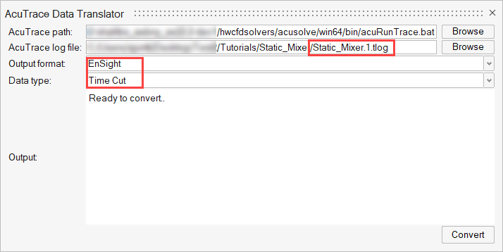

Click the Convert tool.
Figure 55. The AcuTrace Data Translator window opens. - Browse to the location where the AcuTrace log file (*.tlog) is located.
- Set the Output format to Ensight.
Set Data type to Time Cut.
Figure 56. -

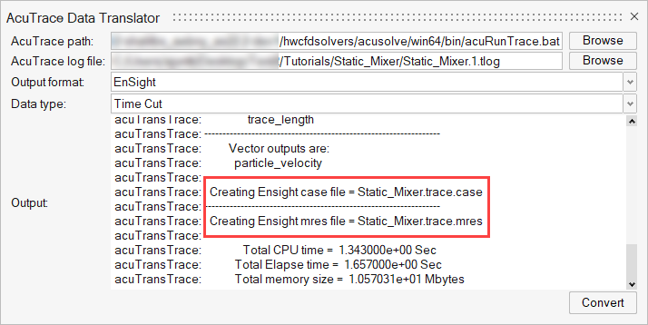

Click Convert.
Once the conversion is successful, it generates two Ensight result files.
Figure 57. - Close the dialog.
