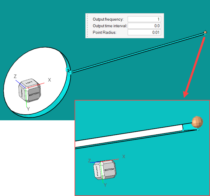

Define Time History Output Points
Time History Output commands enable you to extract the nodal solution at any point within the domain. In this simulation, it would be interesting to observe the displacement at the tip of the cantilever beam.
Form the Solution ribbon, click the body of the
Probe tool.
Figure 29. - Select the top point of the beam tip end on the right-most face of the negative z-axis, as shown in the figure below.
In the microdialog, set the Point Radius to
0.01.
Figure 30. - In the Point Probes legend, rename Point Probe to Tip_Monitor_Point.
Click
on the guide bar.
