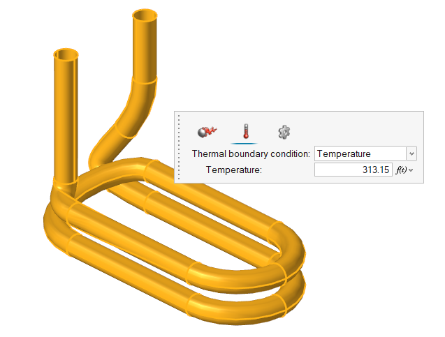

- Hide Exterior_Wall and select the interior faces of the heating element.
- In the microdialog, click the Temperature tab.
Change the Thermal boundary condition to Temperature and
set the Temperature (K) to 313.15.
Figure 19. - Double-click on Wall in the legend and rename it to Pipe.
