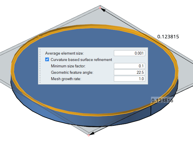

  1. From the Mesh ribbon, click the Surface tool.
    Figure 45.
  2. Using the box selection method, select all the surfaces in the model.
  3. In the microdialog, set the Average element size to 0.002.
    Figure 46.
  4. On the guide bar, click to execute the command and remain in the tool.
  5. Select the surface highlighted in the figure below and hide it by pressing the H key or by right-clicking and select Hide from the context menu.
    Figure 47.
  6. Select the three surfaces highlighted in the figure below.
  7. In the microdialog, set the Average element size to 0.001 and the Mesh growth rate to 1.
    Figure 48.
  8. On the guide bar, click to execute the command and exit the tool.
