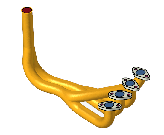

Select the manifold inlets highlighted in the figure below.
Figure 12. -
In the microdialog, set the Inflow velocity type to
Normal, the Normal velocity to
8.0 and the Temperature to
700.

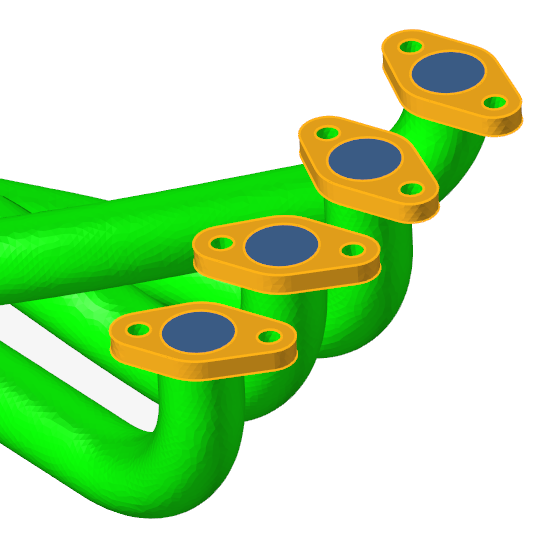

Select the wall flanges.
Figure 18. Note: Make sure you select the bottom and side surfaces of the flanges. In total, 12 surfaces should be selected. -
In the microdialog, click the
Temperature tab, set the Convective heat coefficient
to 100, and the Convective heat reference temperature to
303.
Figure 19. -
Click
on the guide bar.
- Using the Boundaries legend, rename the surface group to Flanges.

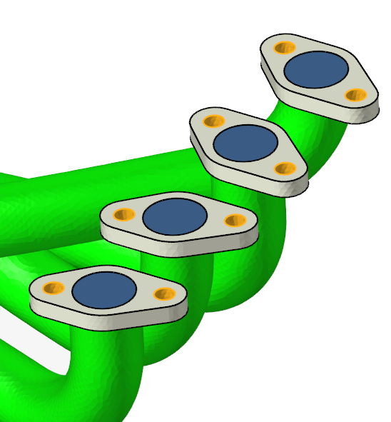

Select the flange bolts.
Figure 20. - In the microdialog, click the Temperature tab and assign the same parameters as the wall flanges.
Click
on the guide bar.
- Using the Boundaries legend, rename the surface group to Flange_Bolts.

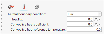

Hide all previously assigned surfaces then select the remaining surface.
Figure 23. -
Check that default values are assigned to the thermal boundary
conditions.
Figure 24. -
Click
on the guide bar.
- Using the Boundaries legend, rename the surface group to Fluid_Walls.
