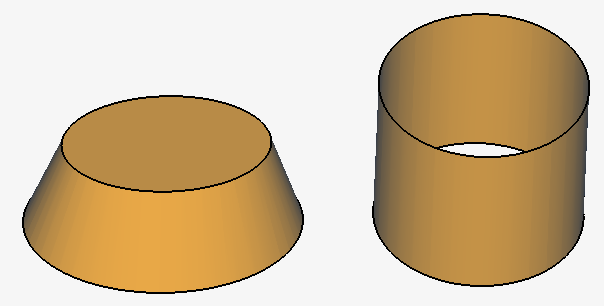

Figure 2. The loft of two ellipses to create a solid (on the left) and the loft of two
elliptic arcs to create a cylindrical surface (on the right).

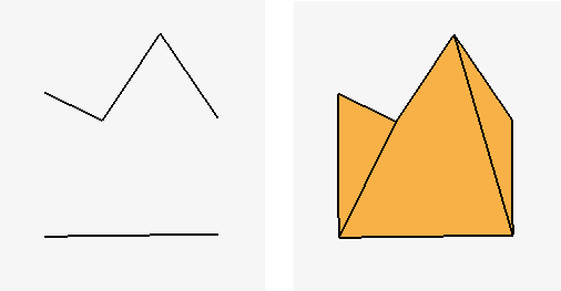

Figure 3. A line and polyline (on the left) and the loft result (on the right).
