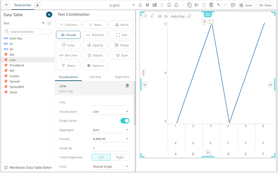

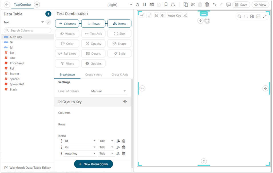

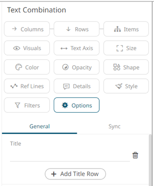

1.     The text combination settings pane is displayed after clicking the Options  button or the Visualization Title (i.e., Text Combination):
2.     To build the hierarchical structure in the text combination graph, drag text columns to the Breakdown Items drop area (e.g., Id, Gr, and Auto Key).

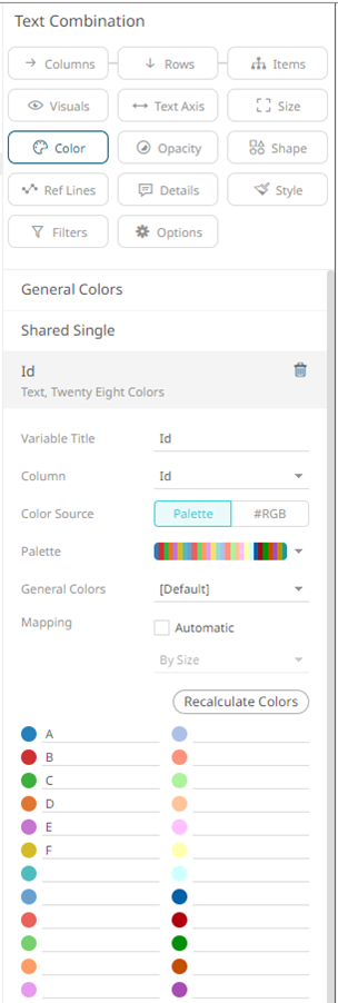

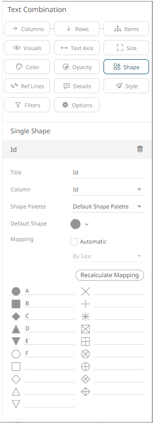

3.     You can opt to drag columns to the Size, Color, Opacity, Shape, Reference Lines, and Details drop area.
For this sample visualization, we dragged the Id column to the Color and Shape variables drop areas.

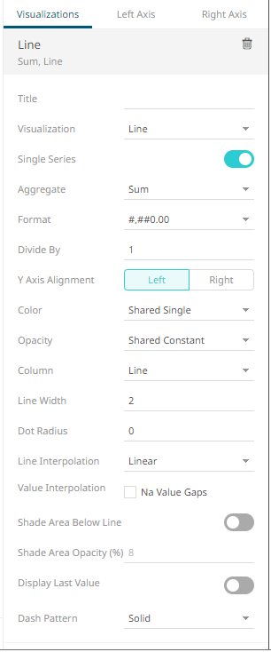

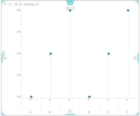

4.     Continue designing the visualization by dragging numeric columns from the Data Table pane to the Visuals variable drop area.
The column (e.g., Line) is added under the Visualizations tab list and, by default, uses the Line graph and the Left Y-Axis alignment.
The X axis displays the multi-level hierarchy based on the three columns added in the breakdown (e.g., Id, Gr, and Auto Key). The Y axis displays the added visual member (e.g., Line).
5.     The properties that you can set will depend on the visualization type that you will add.
The general settings include:
Setting
Title
Title of the visualization.
Visualization
If the visualization is incorrect, instead of deleting, you can just select another one in the Visualization drop-down list. The settings pane will be changed to display the corresponding properties of the selected visualization.
Aggregate
Aggregation method to be used. Default is Sum.
Format
The format that numbers will be displayed in. Panopticon uses the same formatting rules as MS Excel.
Divide By
Select the Divide By value to divide a number:
·         1
·         1000 (by a thousand)
·         10000
·         1000000 (by a million)
·         1000000000 (by a billion)
Y Axis Alignment
The Y-Axis alignment: Left or Right.
Color
The Color variable that will be used for the column:
·         None
·         Shared Single
·         Custom Single
·         Column added to the Column variable
Column/Value Column
The column used for the visualization. If the dragged column is incorrect, instead of deleting, you can just select another column in the Column/Value Column drop-down list.

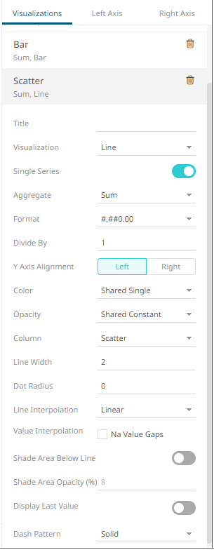

6.     Visual members can be set to display any of the following visualizations:
·         Line
Additional settings include:
Setting
Single Series
Determines whether to use all columns in the breakdown to create a single series or if one column should be used to divide the data into multiple series.
Opacity
Select the Opacity value.
Line Width
Specifies the line width in pixels.
Dot Radius
Specifies the radius of each data point in pixels.
Line Interpolation
Specifies whether the line is Stepped, Linear, or Smooth interpolation.
Value Interpolation Time Gaps
Determines whether time axis gaps (Working Week/Time) are interpolated.
Value Interpolation Na Value Gaps
Determines whether Na value (or missing) gaps are interpolated.
Shade Area Below Line
Defines that opacity shades are applied between the lines and the zero Y grid line.
Shade Area Opacity (%)
Specifies the opacity (transparency) of the shaded area, expressed in percent 0-100 of the opacity value currently set on the line.
Display Last Value
Determines if the flag of the last value will be displayed.
Once enabled, the Show Last Value Title is displayed.
Check the box to display the title of the last value in the flag.
Dash Pattern
Specifies the line pattern. Available options are:
·         Dotted
·         Dashed
·         Solid

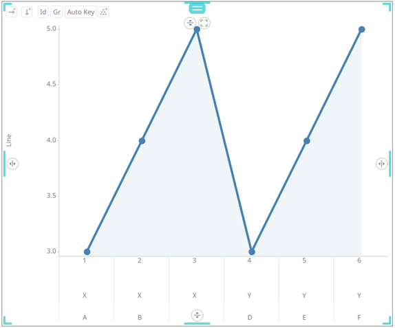

Sample 1. Single Series is enabled, the Line Width is set to 4, the Dot Radius to 6, and the Shade Area Below Line is enabled.
   NOTE
When enabling the Single Series, it is recommended to set the Color variable to Shared Single.

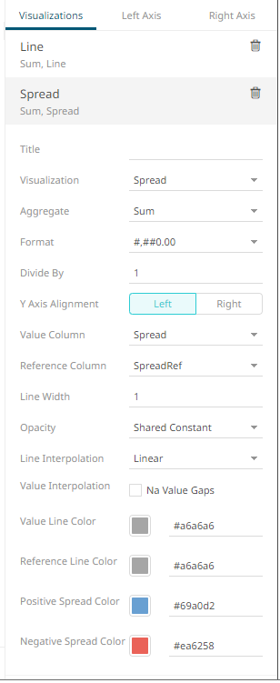

·         Spread
Setting
Reference Column
The field that will be used as the reference line data series.
Line Width
Specifies the width in pixels of the Spread Graph data series lines.
Opacity
Spread Color Opacity
Specifies the level of color transparency/opacity for the Positive and Negative Spread colors. The value is from 0 to 255 with the default set to 128.
Line Interpolation
Specifies the interpolation mode as Linear, Stepped, or Smooth.
Value Line Color
Specifies the color of the value line data series.
Reference Line Color
Specifies the color of the reference line data series.
Positive Spread Color
Specifies the color when the spread between the value and reference is positive.
Negative Spread Color
Specifies the color when the spread between the value and reference is negative.

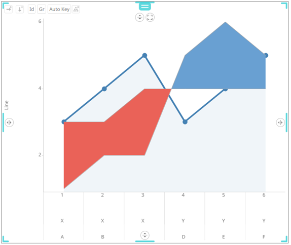

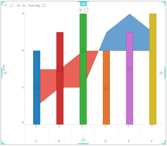

Sample 3. Single Series is enabled in the Line graph. In addition, in the Spread graph, the Value Column is set to Spread, and the Reference Column to SpreadRef.
Sample 4. Single Series is disabled in the Line graph. In addition, in the Spread graph, the Value Column is set to Spread, and the Reference Column to SpreadRef.
The last column in the breakdown (e.g., Auto Key) is used to divide the data into multiple series.

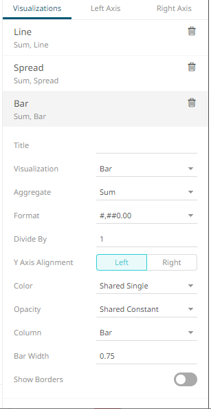

·         Bar
Setting
Opacity
Bar Width
Specifies the width in pixels for each bar.
Show Borders
Determines whether borders are drawn around bars. These are only visible if the Bar Width is greater than 1 pixel.

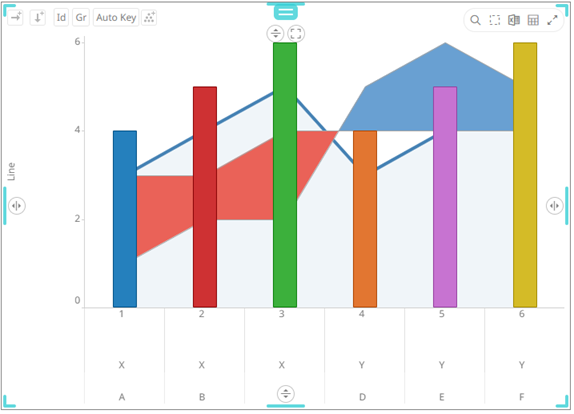

Sample 5. Single Series is enabled in the Line graph. In addition, in the Bar graph, the Color is set to column Id, the Bar Width to 0.3, and the Show Borders is enabled.

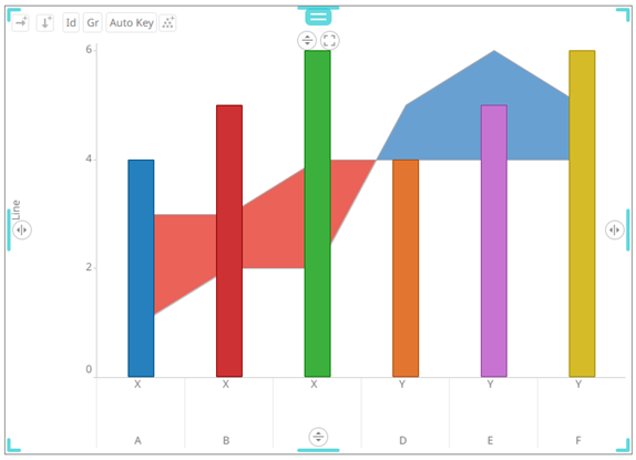

Sample 6. Single Series is disabled in the Line graph. In addition, in the Bar graph, the Color is set to column Id, the Bar Width to 0.3, and the Show Borders is enabled.

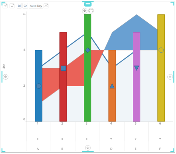

Sample 7. Single Series is enabled in the Line and Scatter graphs. In addition, in the Scatter graph, the Shape column is set to Id and the Min Radius to 3.
Sample 8. Single Series is disabled in the Line and Scatter graphs. In addition, in the Scatter graph, the Shape and Color columns are set to Id and the Min Radius to 3.

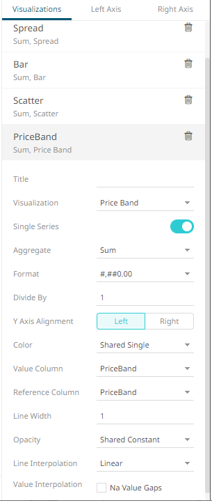

·         Price Band
Setting
Single Series
Reference Column
Line Width
Opacity
Line Interpolation

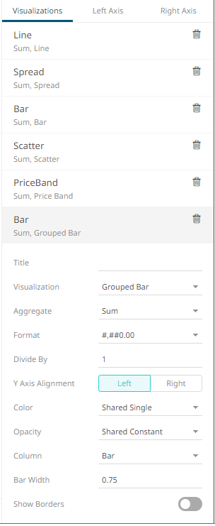

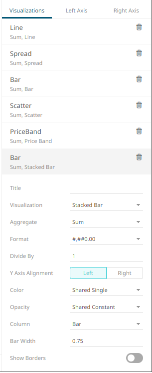

·         Stacked Bar or Grouped Bar
Setting
Bar Width
Specifies the width in pixels of each bar:
NOTE: This is overridden when a column is added in the Size variable. Consequently, the width of the bars will be based on the comparison of their size in relation to where they are located on the X axis.
Show Borders
Specifies whether a border is drawn around bars. These are only visible if the Bar Width is greater than 1 pixel.

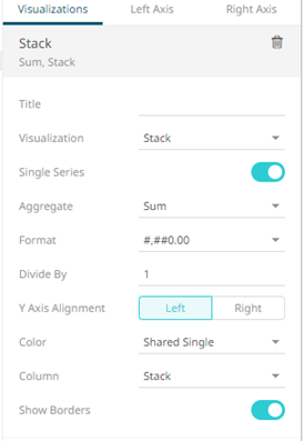

·         Stack
Setting
Single Series
Show Borders
Specifies whether a border is drawn around stacks.
