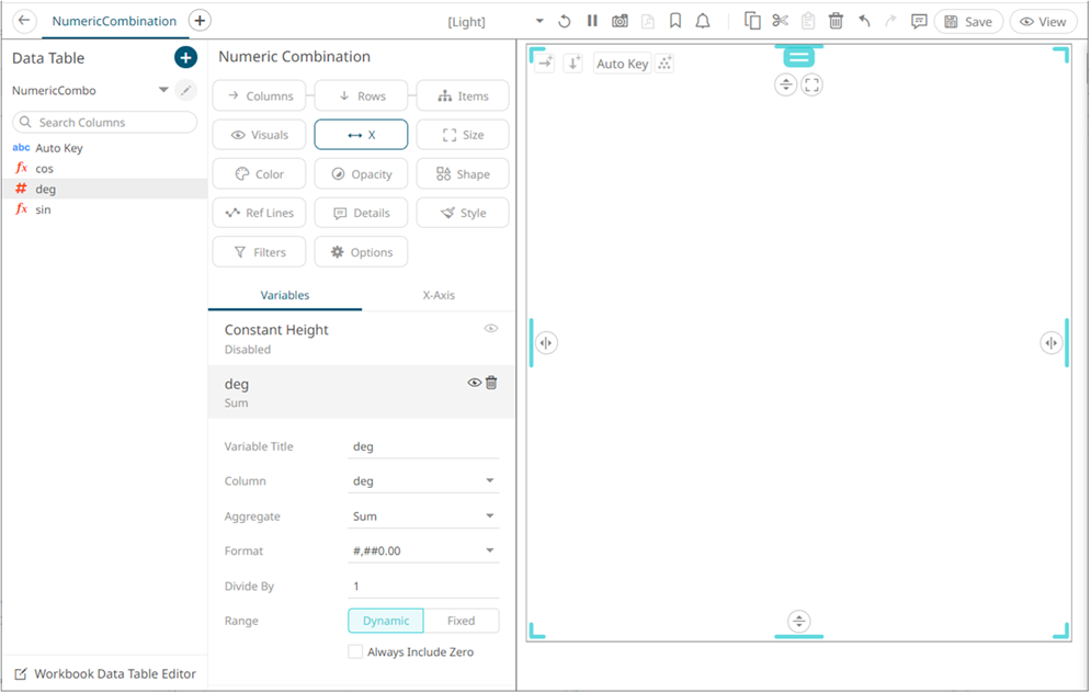

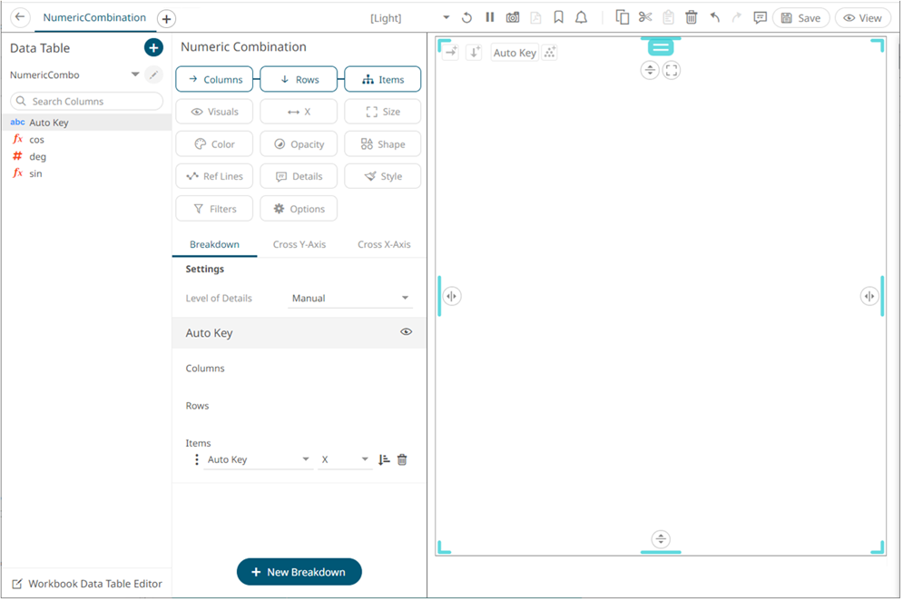

3. To build the hierarchical structure in the numeric combination graph, drag text columns to the Breakdown Items drop area (e.g., Auto Key).
4. To set the X-axis, drag numeric columns from the Data Table pane to the X variable drop area.
For this sample visualization, the deg column will be the used as the height variable.

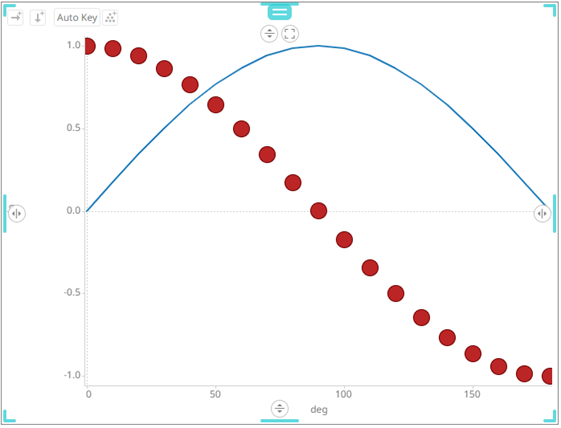

8. Visual members can be set to display any of the following visualizations:

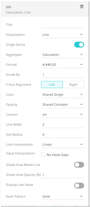

· Line
Additional settings include:
Setting |
Description |
Single Series |
Determines whether to use all columns in the breakdown to create a single series or if one column should be used to divide the data into multiple series. |
Opacity |
Select the Opacity value. |
Line Width |
Specifies the line width in pixels. |
Dot Radius |
Specifies the radius of each data point in pixels. |
Line Interpolation |
Specifies whether the line is Stepped, Linear, or Smooth interpolation. |
Value Interpolation Time Gaps |
Determines whether time axis gaps (Working Week/Time) are interpolated. |
Value Interpolation Na Value Gaps |
Determines whether Na value (or missing) gaps are interpolated. |
Shade Area Below Line |
Defines that opacity shades are applied between the lines and the zero Y grid line. |
Shade Area Opacity (%) |
Specifies the opacity (transparency) of the shaded area, expressed in percent 0-100 of the opacity value currently set on the line. |
Display Last Value |
Determines if the flag of the last value will be displayed. Once enabled, the Show Last Value Title is displayed.
Check the box to display the title of the last value in the flag. |
Dash Pattern |
Specifies the line pattern. Available options are: · Dotted · Dashed · Solid |

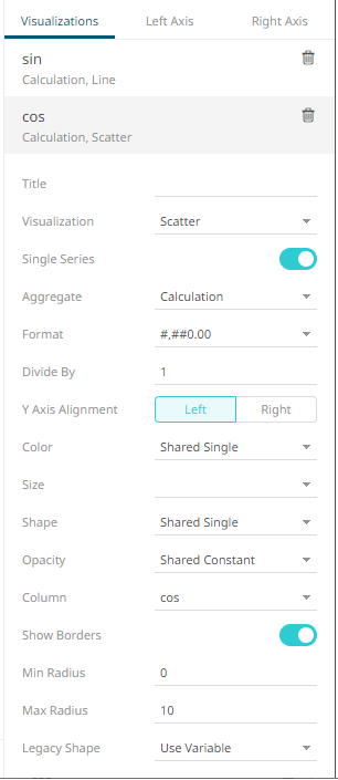

Sample 1. Single Series is enabled, and the Color is set to Custom Single (#2580bd).
· Scatter
Setting |
Description |
Single Series |
Size |
Select the Size variable that will be used. |
Shape |
Select the Shape value. |
Opacity |
Show Borders |
Determines whether a border is drawn around each scatter point. |
Min Radius |
The minimum radius in pixels of the scatter point. |
Max Radius |
The maximum radius in pixels of the scatter point. |
Legacy Shape |
Allows older workbooks to be updated and use the shape variable. Default is Use Variable. Other shapes can also be selected.
Sample 2. Single Series is enabled in the Line and Scatter graphs. In addition, in the Scatter graph, the Color is set to Custom Single (#bb2525).

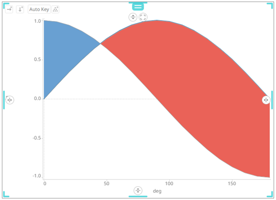

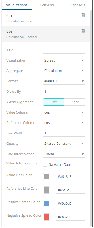

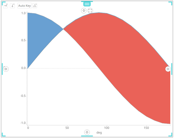

· Spread
Setting |
Description |
Reference Column |
The field that will be used as the reference line data series. |
Line Width |
Specifies the width in pixels of the Spread Graph data series lines. |
Opacity |
Spread Color Opacity |
Specifies the level of color transparency/opacity for the Positive and Negative Spread colors. The value is from 0 to 255 with the default set to 128. |
Specifies the interpolation mode as Linear, Stepped, or Smooth. |
Value Line Color |
Specifies the color of the value line data series. |
Reference Line Color |
Specifies the color of the reference line data series. |
Positive Spread Color |
Specifies the color when the spread between the value and reference is positive. |
Negative Spread Color |
Specifies the color when the spread between the value and reference is negative. |
Sample 3. Single Series is enabled in the Line graph. In addition, in the Spread graph, the Value Column is set to the cos column, and the Reference Column to the sin column.

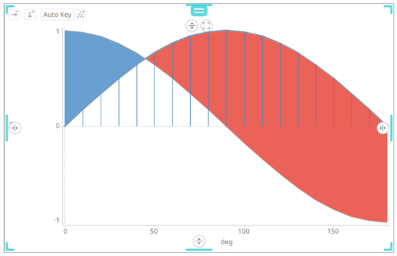

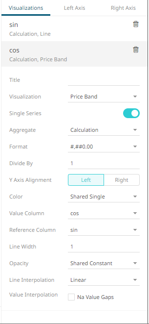

· Price Band
Setting |
Description |
Single Series |
Reference Column |
Line Width |
Opacity |
Sample 4. Single Series is enabled in the Line and Price Band graphs. In addition, in the Price Band graph, the Color is set to By Sign, the Value Column is set to the cos column, and the Reference Color to the sin column.

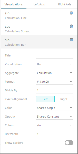

· Bar
Setting |
Description |
Opacity |
Bar Width |
Specifies the width in pixels for each bar. |
Show Borders
Determines whether borders are drawn around bars. These are only visible if the Bar Width is greater than 1 pixel. |
Sample 5. Single Series is enabled in the Line graph. In addition, in the Bar graph, the Column is set to the sin column, the Color to the deg column, and the Bar Width to 2.

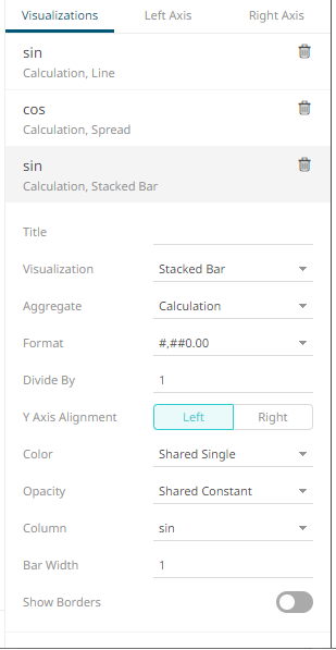

· Stacked Bar or Grouped Bar
Setting |
Description |
Bar Width |
Specifies the width in pixels of each bar. NOTE: This is overridden when a column is added in the Size variable. Consequently, the width of the bars will be based on the comparison of their size in relation to where they are located on the X axis. |
Show Borders |
Specifies whether a border is drawn around bars. These are only visible if the Bar Width is greater than 1 pixel. |
