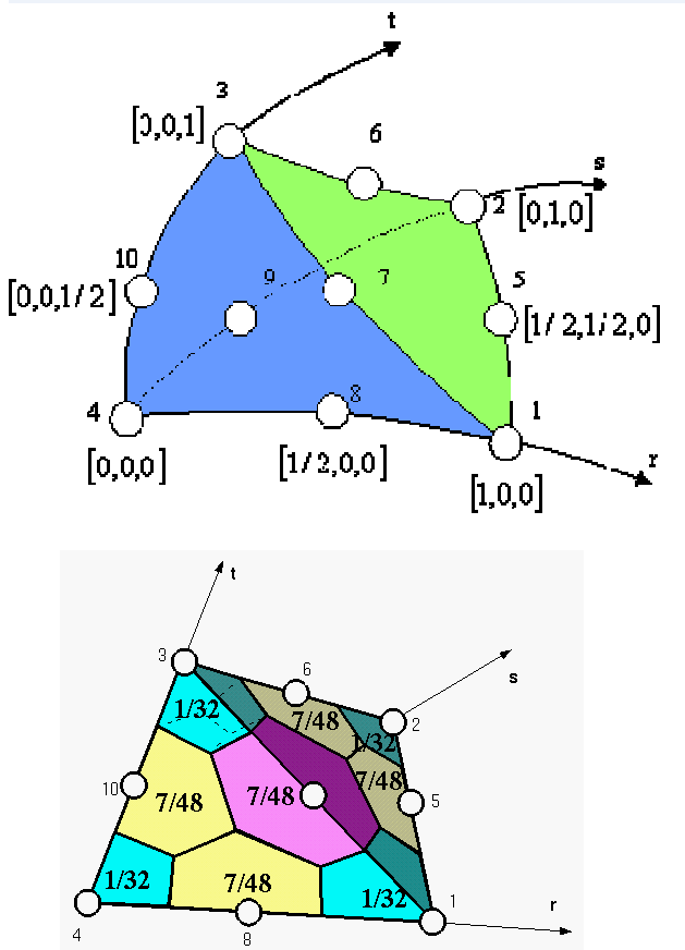

The Radioss solid tetrahedron element is a 10 nodes element
with 4 integration points and a quadratic shape function as shown in Figure 1. Figure 1. (a) Isoparametric 10 Node Tetrahedron; (b) Nodal Mass Distribution
Introducing volume coordinates in an isoparametric frame:
The shape functions are expressed by:(1)(2)(3)(4)(5)(6)(7)(8)(9)(10)
Location of the 4 integration points is expressed by 1.
a
b
c
d
With,
and .
a, b, c, and d are the 4 integration points.

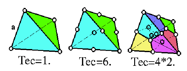

Where, is the characteristic length of element depending on tetra
type. The different types are: Figure 2. Regular 4 Nodes Tetra(12) Figure 3. Regular 10 Nodes Tetra(13)
For another regular tetra obtained by the assemblage of four hexa as shown in Figure 4, the characteristic length is: Figure 4. Other Regular Tetra(14)
CPU Cost and
Time/Element/Cycle
The CPU cost is shown in Figure 5: Figure 5. CPU Cost in TEC

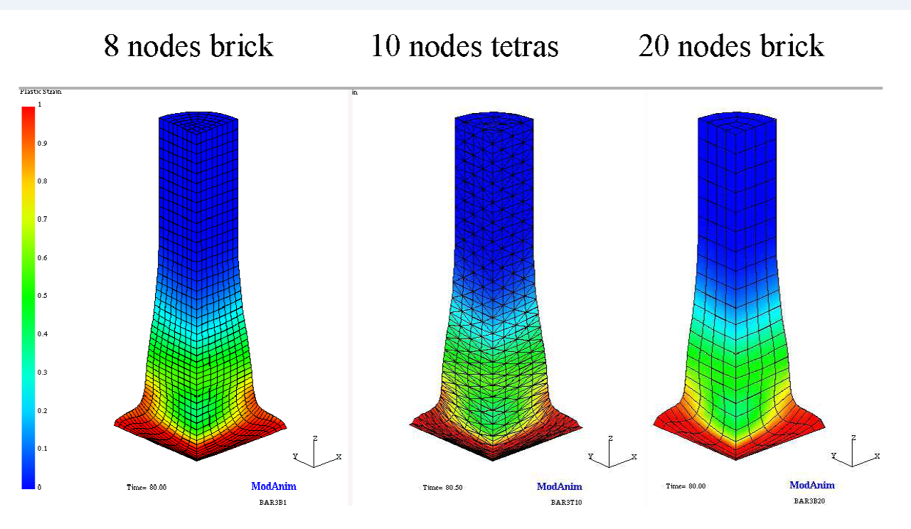

Example: Comparison
Below is a comparison of the 3 types of elements (8-nodes brick, 10-nodes tetra and
20-nodes brick). The results are shown in Figure 6 for a plastic strain contour. Figure 6. Comparison (plastic strain max = 60%)
