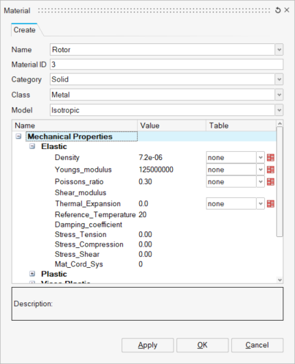

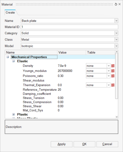

Create Materials and Properties
Create Material

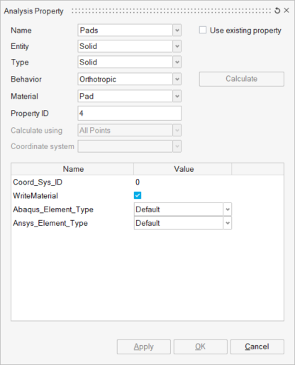

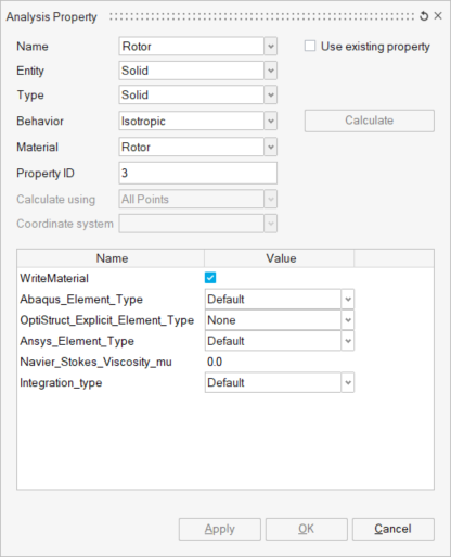

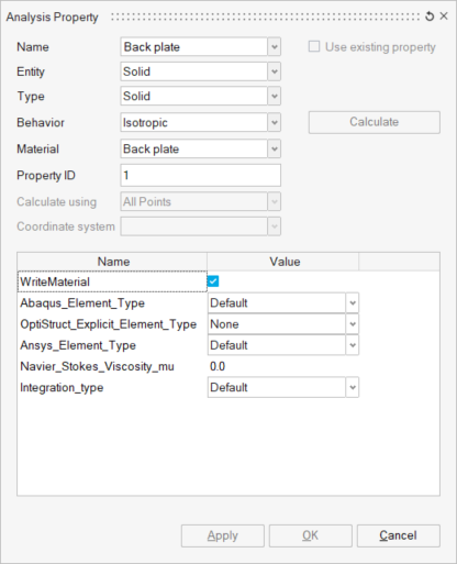

Create Property

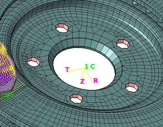

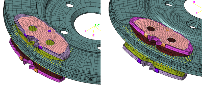

Create Local Coordinate

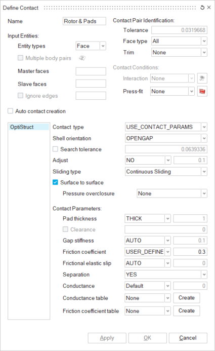

Create Contacts
Contacts are created between the Rotor and Pads to simulate the braking action of the pads against the rotor.

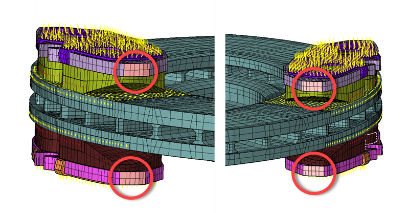

Create Loadcase
Define Brake Pressure

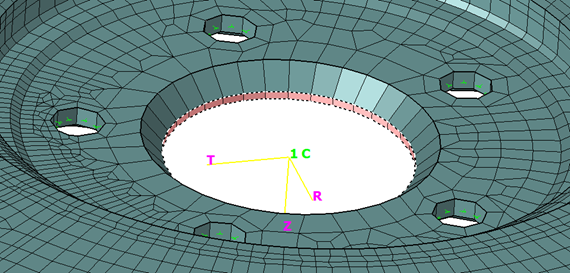

Create Constraints

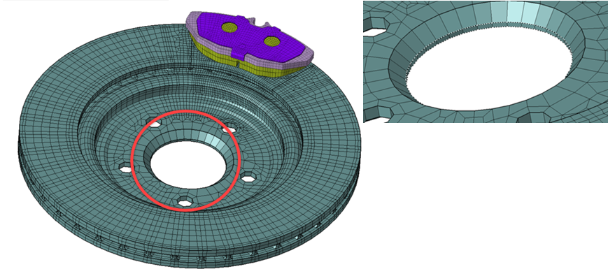

Define Enforced Displacement
The enforced displacement is used to simulate the rotation of the rotor against the brake pads.

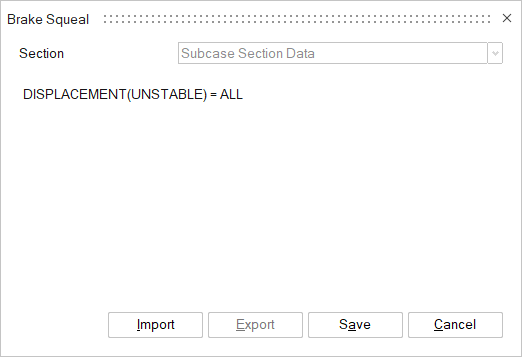

Define Brake Squeal Loadcase

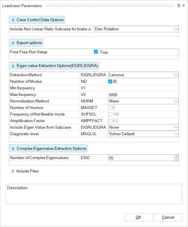

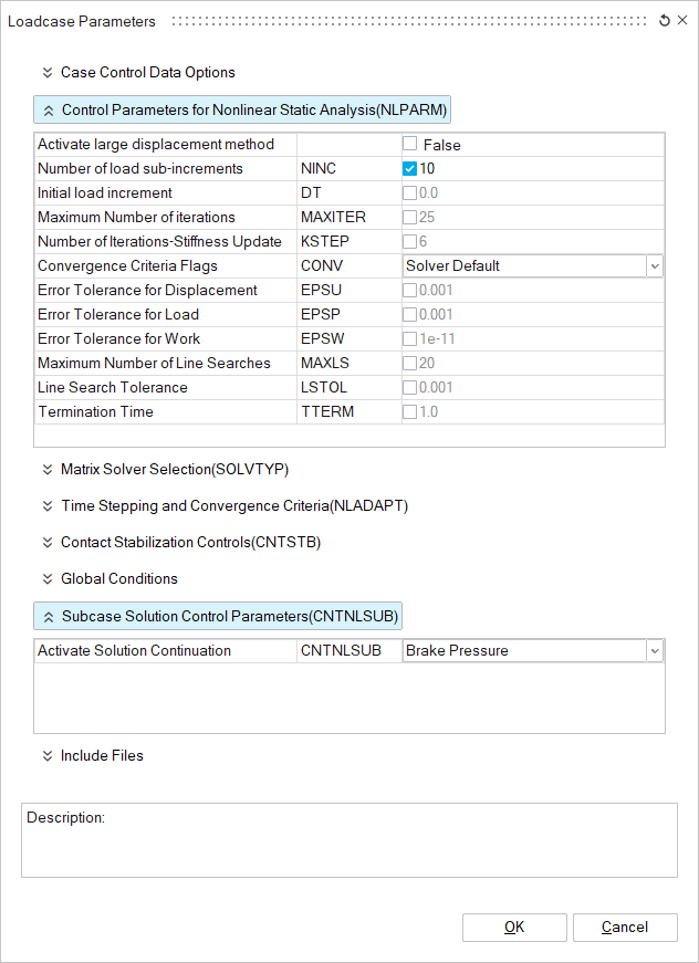

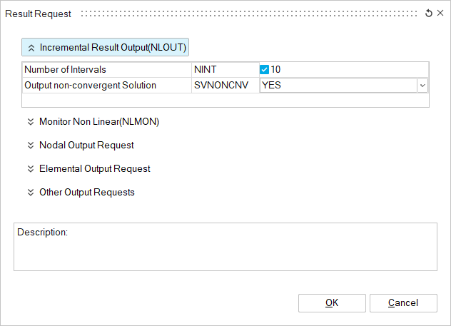

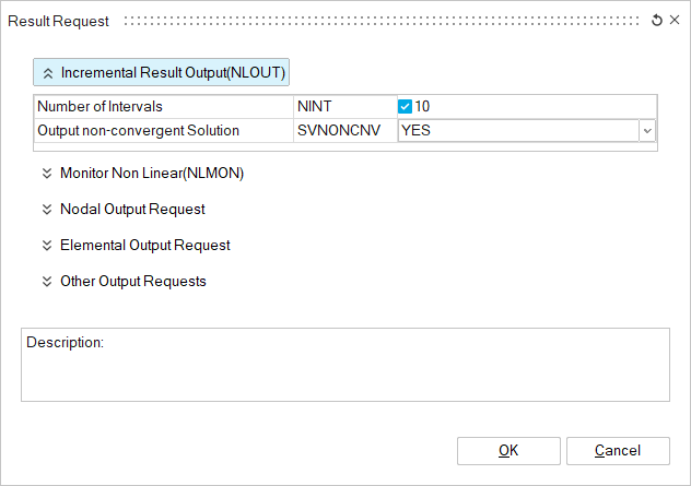

Define Loadcase Parameters and Output Requests

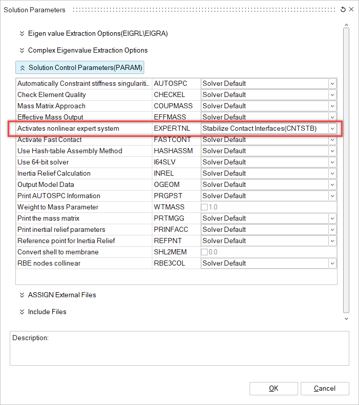

Create Solution Parameters

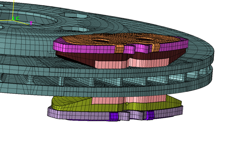

Solve and View Results
Solve the Solution
Interpret the Results
Figure 32. Results Loading After Solving
