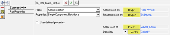

Create the Brake System

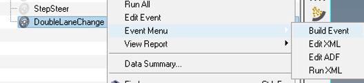

- Closed Loop User Defined Signals
In this step the traction control inputs defined in a Double Lane Change event will be replaced with a Step function expression.
