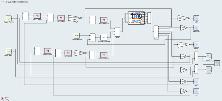

Import the FMU in Twin Activate
Run the Twin Activate Model
Review the Results
Figure 12.
The altittude1 scope shows the altitude of the rotor craft. After about 8 seconds, the quadrotor seems to stabilize at the desired height.
The ScopeXY scope shows the target X, Y path (red) vs. the actual X, Y path (pink) of the quadrotor.
