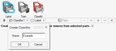

                From the guide bar, select the
                        Classifier drop-down menu and select
                        Create New to create a new classifier.
Figure 2.A new folder, named after the classifier, is created in the following directory: C:\<user_profile>\Documents\Altair\Altair_AI\Classify. All files related to the classifier are stored in this folder.

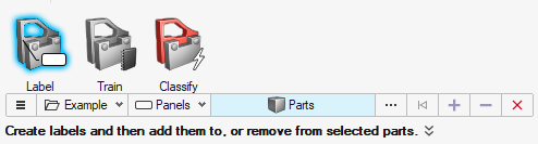

                From the Classify > Label
                    guide bar, select the Label
                    drop-down menu to create a new label named Panels.
Figure 3. -

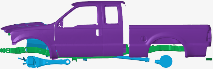

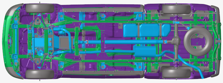

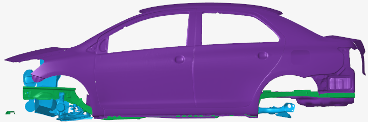

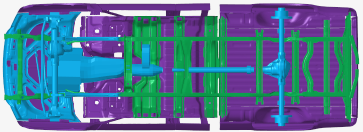

Classify Parts by Predicting Their Label and Creating Part Sets
- Open the silverado.hm model.
                From the Assembly ribbon, click the Classify > Classify tool.
Figure 15. - From the guide bar, select the Classifier drop-down menu to select the classifier you trained in the previous steps.
                        Files drop-down menu to select a trained machine
                    learning model file from the selected classifier’s folder.
                Select the file that has “_1” as a suffix appended to its name. This is the file created after training the model for the second time. The Parts selector activates.
 - With the Parts selector active, select all parts to classify under the labels of the selected classifier/trained model.
                From the guide bar, click
 to review the Certainty Ratio value that will be used for the classification
                    run. Set the Certainty Ratio to
                        0.8 (see Certainty Ratio, Unclear Predictions, and Unrecognized Parts for more information on this feature).
                Click Classify to classify the selected parts. The parts
                    are color-coded based on the predicted labels. Part sets are created for review
                    and traceability after exiting the Classify tool.
Figure 16.
Figure 17. -
                Change the Certainty Ratio value to
                        0.6 and perform a new classification run:
Figure 18.Notice how the Certainty Ratio value affects the classification results (the number of parts under each label). (See Certainty Ratio, Unclear Predictions, and Unrecognized Parts for more information on this feature).
