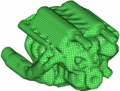

                        ![]() Figure 1. Coarse STL Mesh Used as Input  |
                        ![]() Figure 2. Shell Mesh Wrapped Around the Original STL Mesh  |

One use case for shrink wrapping is when you need to convert an .stl representation of a model into a tria/quad mesh; using shrink wrap provides a quick and efficient way of achieving this. Similarly, crash analysis does not require a highly-detailed powertrain model; in such cases you can use the shrink wrap mesh to quickly generate a simplified approximation of a detailed powertrain model. Crash analysts can then use that coarser shrink wrap representation within the crash simulation model.
