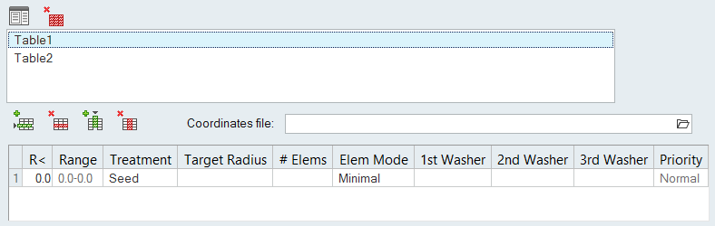

Use file for circular hole recognition
Specify additional files containing X, Y, Z center locations of all of the holes to consider.
Multiple files can be specified, each with their own definitions. The order of the files determines the order of precedence in the case where there are overlapping or conflicting definitions.
Click (Add Table) to add a new table for creating a hole file. Click (Delete Table) to delete the specified hole file table.
Figure 33.
This is useful for special treatment of specific holes, usually bolt holes. BatchMesher compares the defined locations to the holes in the model, and prioritizes the holes that match. All of the options for Surface hole recognition are available for these holes. If one or more holes files are defined, BatchMesher looks for the found holes in each file, in the order the files are defined. If found, it applies the washer table linked to the first found file to the corresponding holes. If a hole is not found in any file, the settings from the default general surface holes table are used.
The holes file must contain one line for each hole, with the values either space, tab or comma separated. Each line contains a line number followed by the X, Y, Z locations of each hole center.
