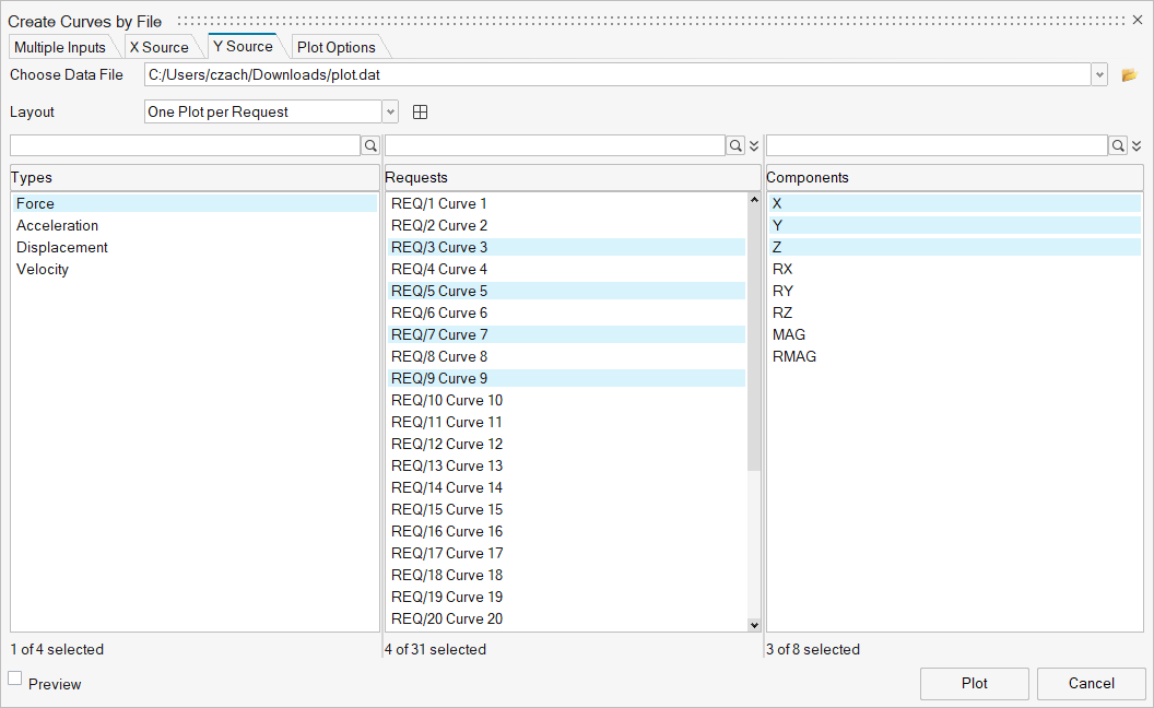

  3. Click File > Open to open the Create Curves by File dialog.
  4. From the Y Source tab, use the Choose Data Field file browser to open the file plot.dat.
  5. From the X Source tab, select Time.
  6. From the Y Source tab, select the following:
    1. Type: Force
    2. Request: REQ/3 Curve 3, REQ/5 Curve 5, REQ/7 Curve 7, and REQ/9 Curve9
    3. Components: X

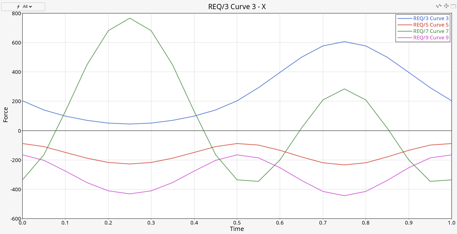

  7. Click Plot and review the plot created.
  8. Leave the Create Curves by File dialog open.

  1. From the Create Curves by File dialog, go to Y Source > Components and select X, Y, and Z.
  2. From the Layout drop-down menu, select One Plot per Request.

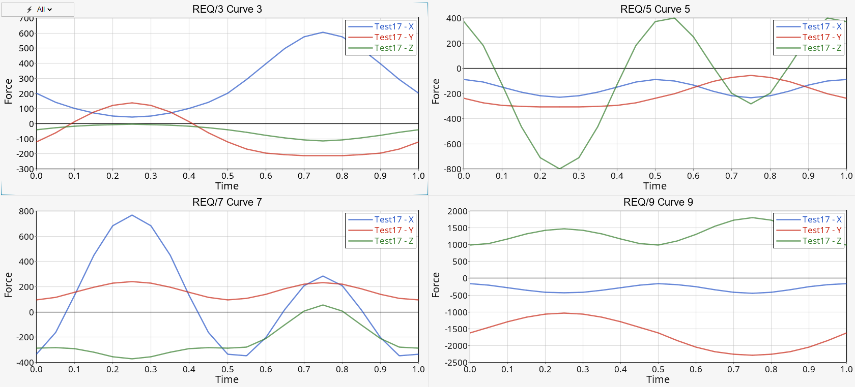

  3. Click the Set Page Layout icon, , and select the four window layout.
  4. Click Plot.
    Figure 3.
  5. Leave the dialog open.

  6. Click Curve Options to define the following:
    • Select Show Prefix.
    • Label Prefix: Test17.
    • Leave Show Label selected.
    • Label Scheme: Default.

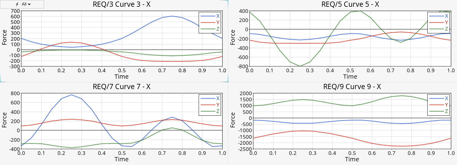

  7. Click Plot to review these curves on page 3.
    Figure 4.
  8. Leave the dialog open.
