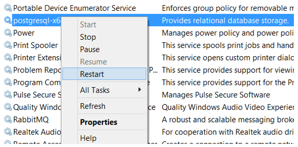

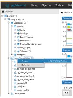

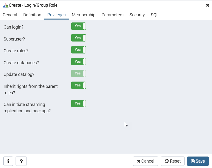

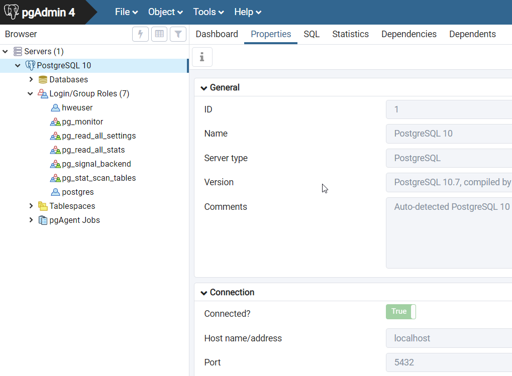

Install PostgreSQL
In this section you will learn how to install PostgreSQL.
It is recommended to perform the installation using the values and options as detailed below. Also, when prompted for a Windows admin password, create a new password.
