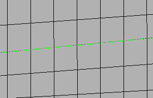

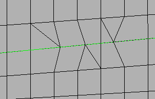

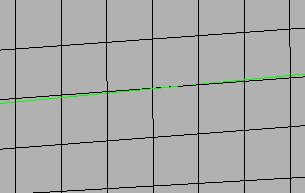

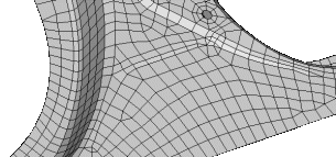

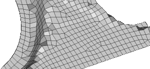

Flow Align Produces a more orthogonal quad-dominant mesh. Only available when the Element Type is set to Mixed.
Figure 1. Flow Alignment Off
Figure 2. Flow Alignment On. Notice a straighter row of elements is produced.Size Enforces the global mesh element size with minimal min/max element size variations. Only available when Element Type is set to Mixed and Flow: Align is enabled.

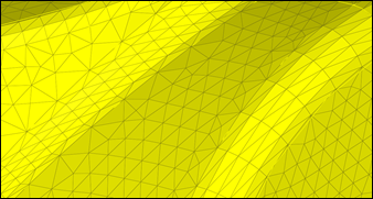

Figure 6. Before Re-Meshing
Figure 7. After Re-Meshing, Surface Edges Selected - None

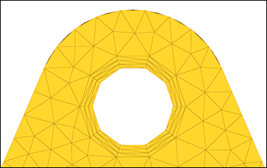

Figure 12. . With an appropriate value, the features lines are preserved.
Figure 13. . If the feature angle is too high, the feature lines are blurred.Element Type Type of elements used to create mesh during automatic meshing. For more information, see Mesh Types.

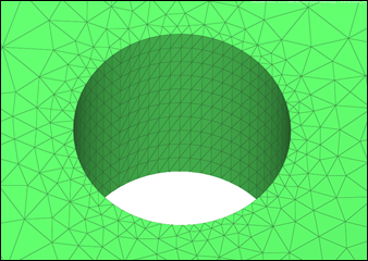

Figure 21. Before Re-Meshing
Figure 22. After Re-Meshing, with Surface Edges Selected - None

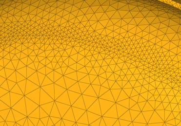

Figure 23. Growth Rate. Elements further from the features grow larger with each row.Span Angle Controls the element size at curve input. The smaller the angle, the more refined curvature will be and the more preserved the input shape will be. By default span angle is 25.0 degrees. Valid only for element-based controls

Washer
Figure 34. Washer
| Parameter | Description |
| Washer Width | Define the width of the washer around the circle. |
| Number of Layers | Defines the number of mesh layers to create around the circle. |
