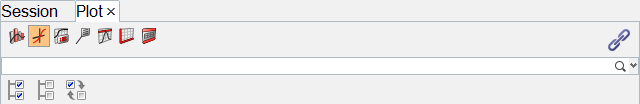

The Plot Browser contains several ways to filter your plot data to display specific plot entities in the browser.
Enter Search String Field
- Press the Enter key
- Click the magnifying glass.
- Use the Add as Filter option in the properties table.

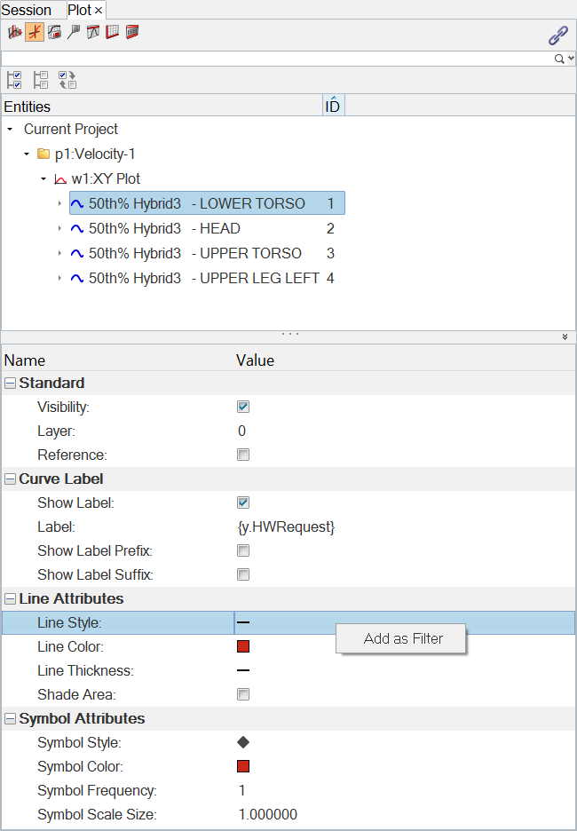

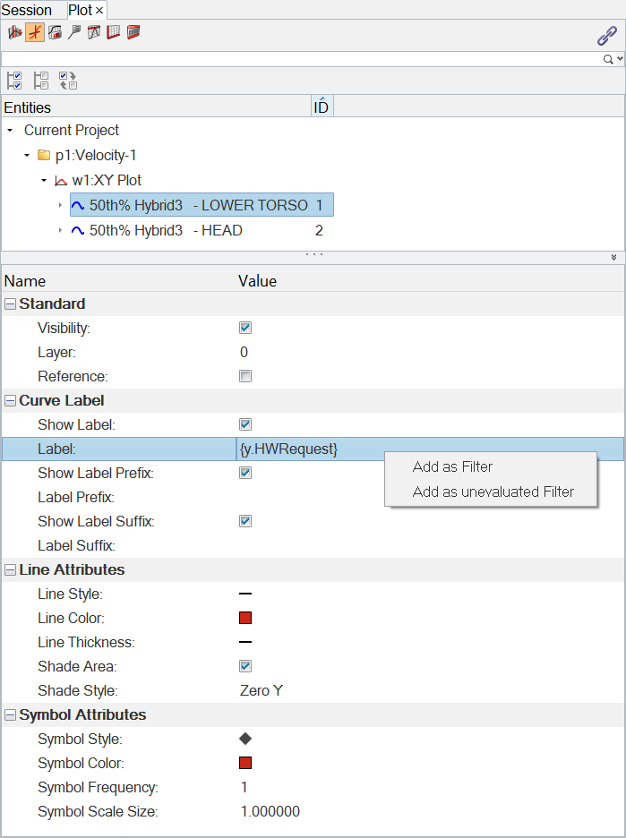

To apply a filter on a curve or on an x/y vector property, right-click on the curve or x/y vector’s property in the Properties Table and select Add as filter, as shown below.
Figure 3.

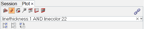

The filter is added to the search field at the top of the browser. If you add more than one filter type, it will be added to the search field, with the word AND, as shown below. In this example, Line Thickness and Line Color were both added as filters.
Figure 4.

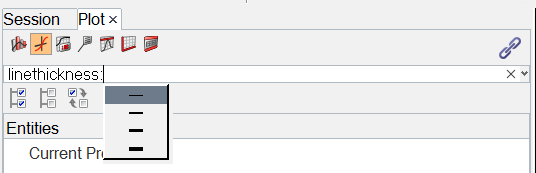

If you want to change the line thickness or line color search criteria, you can backspace to remove the number from the search field and a context sensitive menu is displayed containing the line thickness types or color palette. Selecting a new line thickness type or line color automatically adds the number equivalent to the search field.
Figure 5.

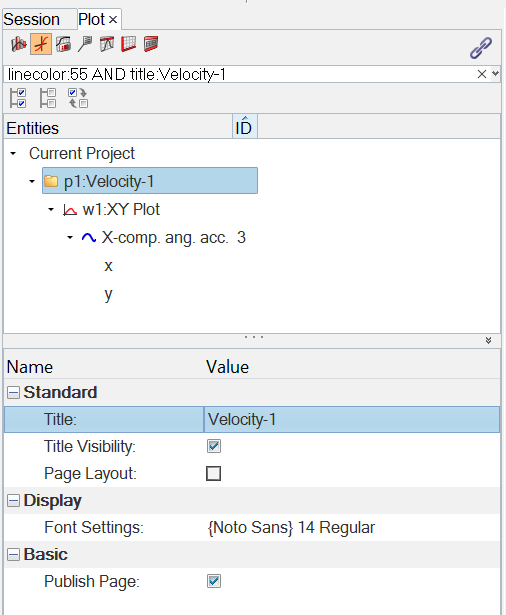

- Window and entity properties
Figure 7. - Page and entity properties

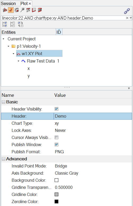

Figure 8.

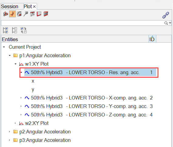

You can define the position where you want to paste the curve. In the image below, you can cut the curve surrounded with the red border and add it to the window 2 on page 2.
Figure 10.
Figure 11.

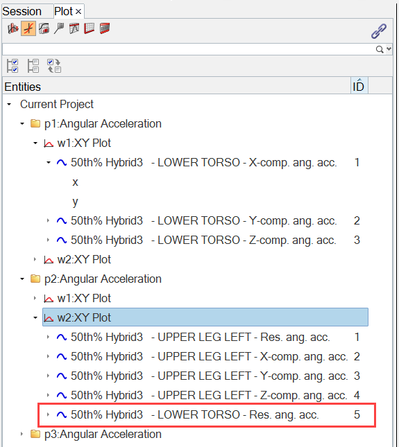

Filter Example

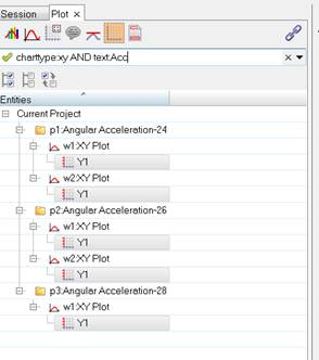

The example below illustrates searching for all axes with Acceleration in the label on an xy plot.
Figure 12.
