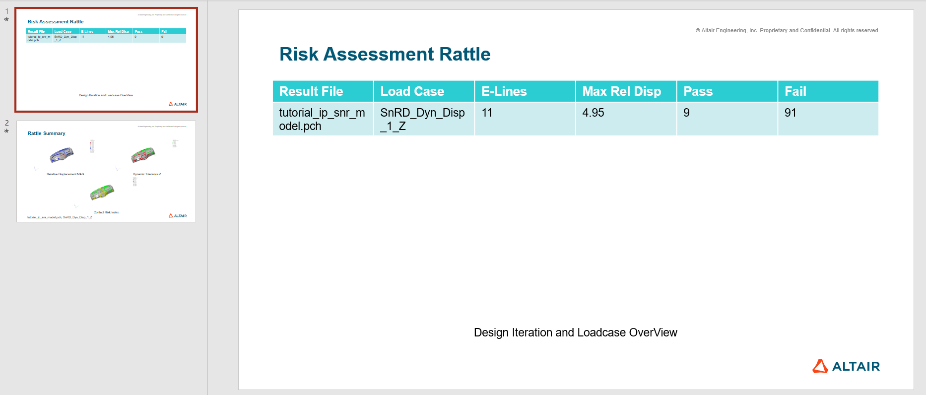

Risk Assessment
In this step, you will evaluate risks for Squeak and Rattle in the Risk Assessment.
Generate Summary Report
In this step, you will export a squeak and rattle summary report using the Report tool.
