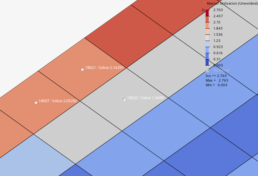

Both the welds and unwelded elements are evaluated.Figure 19.
By default, Max Utilization - Unwelded is contoured.
In the Results Explorer, select Top
Layer and MinStress_X from the contour
result drop-down menus and click
The selected result type is contoured.Figure 20. -
Add tags to elements.
MasterUtilizationUnWelded from the contour
result drop-down menu and click
- Select elements to tag.
Click
on the entity selector.
The selected elements are tagged with IDs and utilization values.Figure 21.
