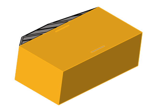

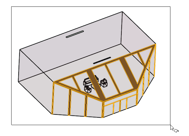

  1. From the menu bar, click File > Import > Geometry Model.
  2. In the Import File dialog, browse to your working directory then select ACU-T3201_Atrium.x_t and click Open.
  3. In the Geometry Import Options dialog, leave all the default options unchanged then click Import.
    Figure 5.
    Figure 6.
    The model contains an atrium with glass panes supported by an aluminum frame in the front. Air enters from the opening on the roof in the front and exits through the outlet in the rear.

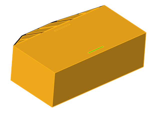

  2. In the modeling window, click the inlet surface highlighted in the figure below.
    Figure 17.
  3. In the microdialog, enter the values shown below.
    Figure 18.
  4. Click on the guide bar to execute the changes.
  5. Click the Outlet tool.
    Figure 19.
  6. Select the surface highlighted in the figure below then click on the guide bar.
    Figure 20.

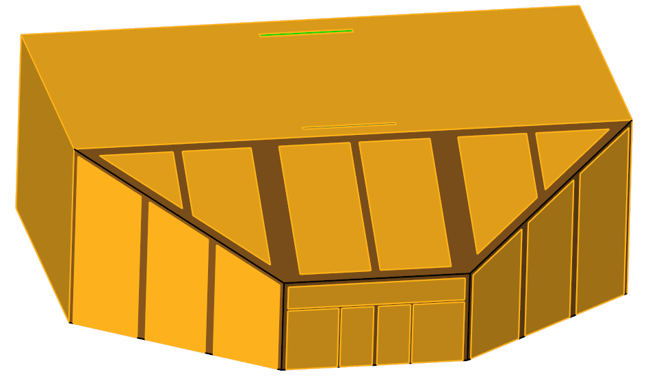

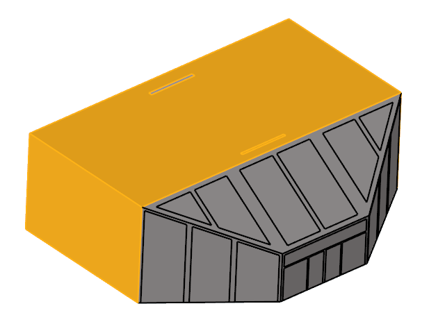

  2. Select the three wall surfaces, the inlet, and the roof surface, as highlighted in the figures below.
    Figure 37. Front-Side of the Model
    Figure 38. Back-Side of the Model

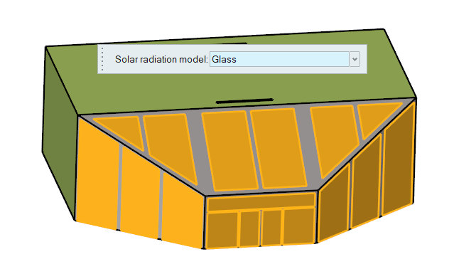

  4. Select all the glass surfaces shown in the figure below, assign the Glass model to them, then click on the guide bar.
    Figure 39.

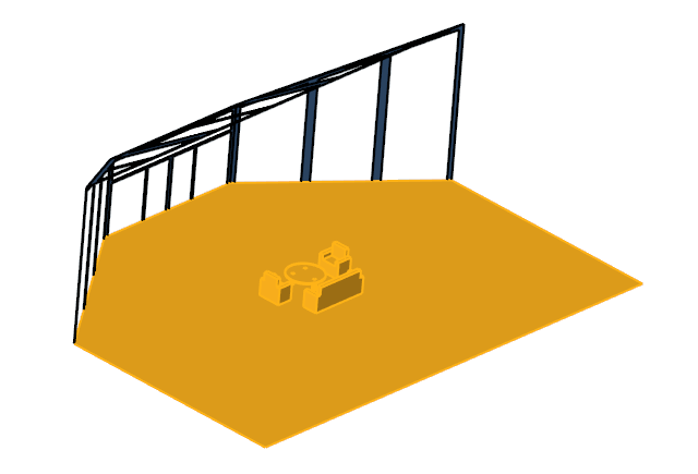

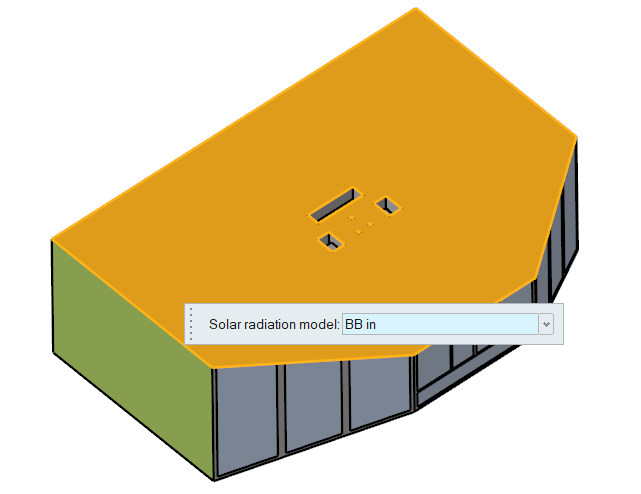

  5. Rotate the model and select the floor surface. In the microdialog, assign the BB in model then click on the guide bar.
    Figure 40.

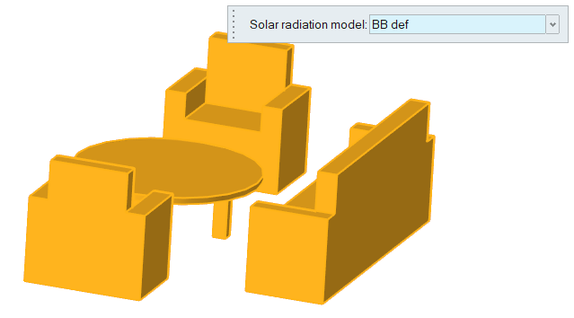

  7. Select the surfaces of the couch, table, and chairs, assign the BB def model to them, then click on the guide bar.
    Figure 41.
