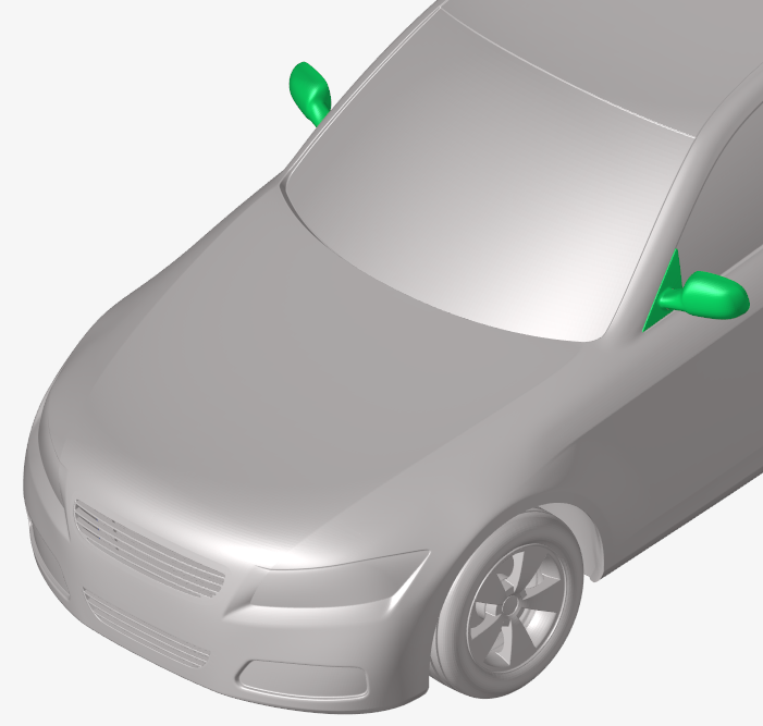

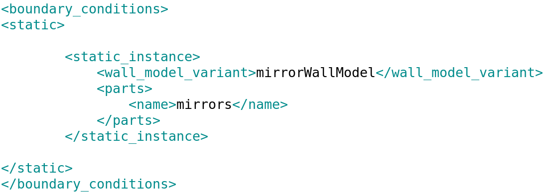

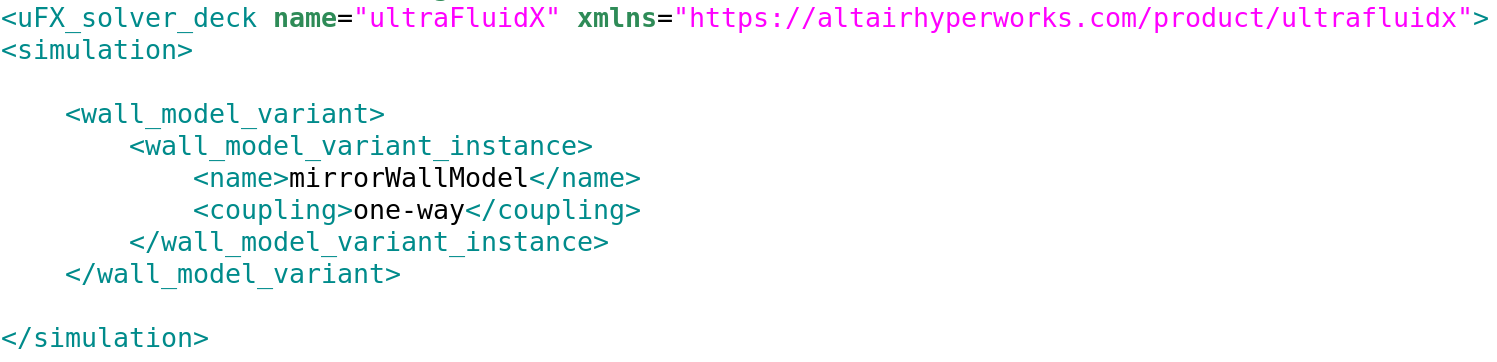

- Application: Mirrors
- The mirrors typically have a high curvature and thin boundary layers
before separating over the cover edge. To model the correct physics on
the mirror, a wall model variant is specified on the mirror part. The
wall model variant on the mirrors uses the one-way coupled model instead
of the default two-way coupled model. The one-way coupled model is more
robust in predicting the flow and drag when there is not enough
resolution and length to develop the boundary layer fluctuations.Figure 17.
