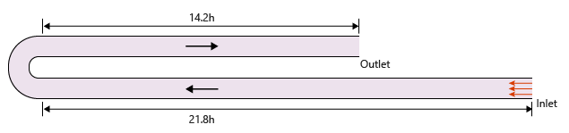

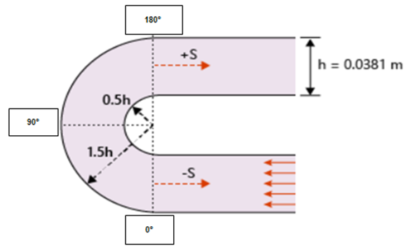

Problem Description
Figure 1. Critical Dimensions and Parameters for Simulating Turbulent Flow in the 180 degree U-Duct

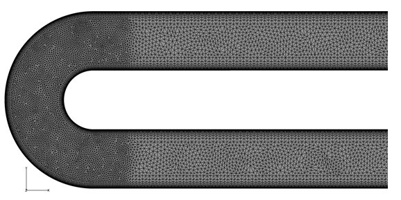

Figure 2. Mesh Used for Simulating Turbulent Flow in the 180 Degree U-Duct

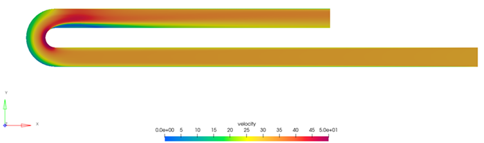

Figure 3. Velocity Contours in Stream Wise Plane

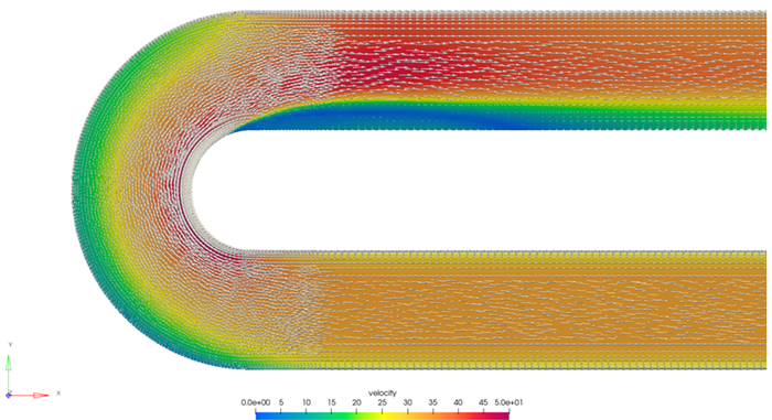

Figure 4. Close up View of Velocity Vectors and Velocity Contours at 180 Degree Bend

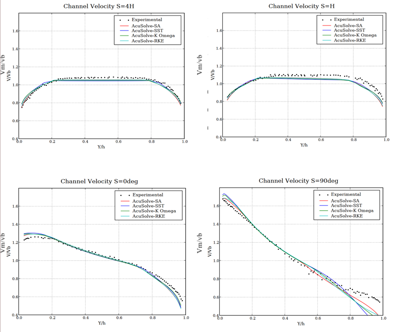

Summary
The AcuSolve solution compares well with experimental results for flow past the 180 degree U-duct. The experimental value for the ratio of Velocity magnitude to inlet bulk velocity at different sections of the U-duct is presented with the corresponding AcuSolve result for various turbulence models. The performance of the Spalart Allmaras turbulence model was found to improve when the rotation curvature correction is included in the numerical formulation (enabled by default). In this application, AcuSolve demonstrates the ability to predict the complex boundary layer separation and reattachment resulting from the curvature of the channel.
