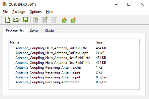

Adding Additional Files to the Package
The .pre file is read to determine the required files to perform the simulation. Files that form part of the Feko project (but not required for the simulation) can be added manually.

QUEUEFEKO is a graphical user interface (GUI) application that can create a package which you can transport to a remote queuing system. Created packages can be extracted once the simulation on the queuing system has been completed.
The QUEUEFEKO graphical interface is used on the local machine to create the package that is then transferred to the compute cluster. On the compute cluster, use the queuefeko script to add a package to an execution queue.
The steps for creating and extracting a package for remote execution, are explained.
A package configuration file is not the package itself but includes the settings to create a package. The file can be reused to create packages with similar settings.
For the remote cluster, you can specify the Solver options used.
For the remote cluster, you can specify the specific job queue that is to be used and set up email notifications when the job starts or completes.
Create the package that is to be added to the execution queue.
Transfer the package to the remote cluster where it is placed in an execution queue.
After the simulation has completed, a new output package (.output.pkg) is available for download from the remote cluster machine to the local machine. Extract the package using QUEUEFEKO.
Results obtained from the remote cluster machine can be viewed in POSTFEKO on a local machine as if the simulation was run locally.
