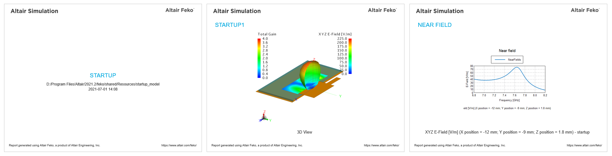

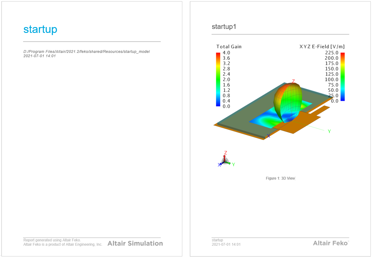

Figure 2. Example showing the Feko template for the quick report (Microsoft Word document).
Figure 3. Example showing the Feko template for the quick report (Microsoft PowerPoint document).
