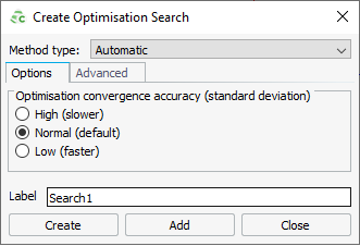

Create Optimisation Search - Options Tab
Figure 1. The Create Optimisation Search dialog, Options tab
- Optimisation convergence accuracy (standard deviation)
- This setting controls the level of accuracy required by the search algorithm to converge. The three options, High (slower), Normal (default) and Low (faster) modify the conditions under which the search algorithm converges, and is also dependent on which optimisation Method type is chosen, since some techniques have a predetermined number of samples.
- Default number of points
- Only applicable when the Method type is set to Grid search. Specify the number of grid points to use for each optimisation parameter in the predefined grid. This value is used for the Grid points on the Optimisation parameters dialog if no values are specified.

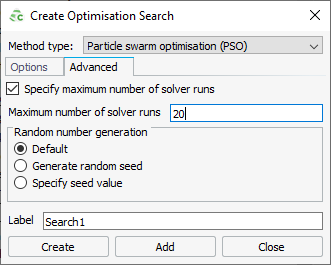

Add Optimisation Search - Advanced Tab
Figure 2. The Add optimisation search dialog, Advanced tab.
- Specify maximum number of solver runs
The optimisation process is terminated when the Feko Solver is launched, the specified number of times during the optimisation process.
For the PSO and GA methods, should a full swarm or generation not be generated within the allowable number of allocated runs, the optimisation may terminate before the indicated number of solver runs.
When an optimisation process terminates due to reaching the value in Specify maximum number of solver runs, the optimum solution found up to that point and the optimisation process information are made available.
- Random number generation
- This group is visible for those methods that make use of randomised sampling and allows setting the seed value.
