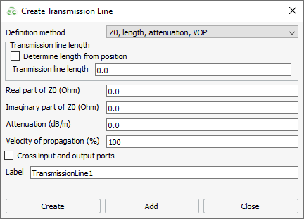

Define an ideal, non-radiating transmission line. In the network schematic view, connect the transmission line to
a port, other transmission lines or general networks.
connect the transmission line to a port, other transmission lines or general
networks.
On the Source/Load tab, in the
Loads/Networks group, click the TX Line icon.
Figure 1. The Create Transmission Line dialog.
From the Definition methoddrop-down list, specify one of the following:
Z0, length, attenuation, VOP
Z0, length, medium
Specify the transmission line length using one of the following:
To determine the distance between the start point and end point of the
transmission line automatically, select the Determine length from
position check box.
To specify the transmission line length, in the Transmission
line length field, enter the length.
In the Real part of Z0 (Ohm) field, specify the real
value.
In the Imaginary part of Z0 (Ohm) field, specify the
imaginary value.
Specify one of the following, depending on the selection in 2.
Attenuation (dB/m)
Losses of the transmission line in dB/m.
Note: The propagation
constant is taken as the propagation constant of the medium
in which the start and end ports are located. As a result,
the attenuation specified is added to any losses of this
medium.
Velocity of propagation
The propagation speed through the transmission line relative to
the speed of light.
Medium
The medium used as the background medium for the transmission
line.
The positive port voltage is in the direction of the connected segment
(from the start to the end point of the segment). As a result, the input and output
ports of the transmission line have unique orientations.
[Optional] Select the Cross input and output ports check
box to cross the input and output ports.
In the Label field, add a unique label for the
transmission line.
Click the Create button to create the transmission
line and to close the dialog.
View the transmission line definition in the model tree
(Configuration tab), under Non-radiating
networks.
The transmission line is added to the network schematic view where you can
networks.
