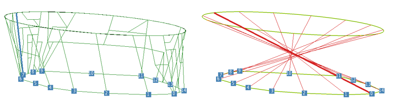

To achieve a valid loft, it may be necessary to reverse the orientation of
one of the profiles in the loft, so that the bounding edge matching is done in the
opposite direction along the profile.
[Optional] Select the Reverse orientation check box to
reverse the orientation of one of the profiles in the loft.
Figure 2. Loft preview showing a valid loft (on the left) and an invalid loft
(to the right).
When lofting closed edges or faces, you can introduce twists or remove
twists to change the relative alignment of the two profiles in the
loft.
In the Alignment index field, increase the number to
change the alignment index.
