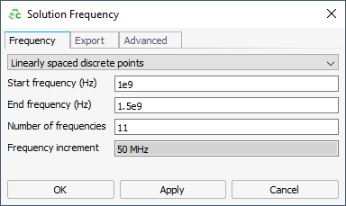

Figure 1. The Solution frequency dialog (Frequency tab).
