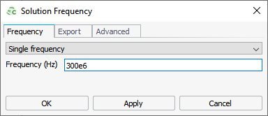

Setting the Frequency
Specify a single global frequency as 300 MHz.
myProject.Contents.SolutionConfigurations.GlobalFrequency.Start = "300e6"
Figure 1. Specify a single global frequency as 300 MHz.
Start = "300e6"
.Start = "300e6"
SolutionConfiguration object has property GlobalFrequency.
