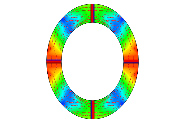

- Plot the currents for the CharacteristicModesConfiguration1 (mode index = 1) in the 3D view.

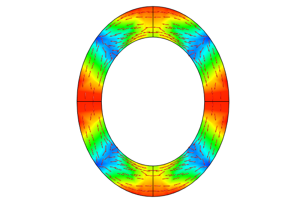

- Plot the currents for StandardConfiguration1 in a second 3D view.
- Compare the currents for the first mode in CharacteristicModesConfiguration1 with the reconstructed mode using sources placed in the appropriate locations (StandardConfiguration1).
Figure 1. The first characteristic mode of the MIMO ring.
Figure 2. The first reconstructed mode of the MIMO ring. -

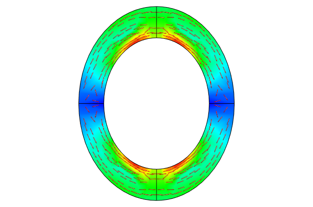

- Plot the currents for the CharacteristicModesConfiguration1 (mode index = 5) in a third 3D view.

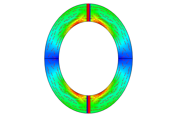

- Plot the currents for StandardConfiguration2 in a fourth 3D view.
- Compare the currents for the fifth mode in CharacteristicModesConfiguration1 with the reconstructed mode using sources placed in the appropriate locations (StandardConfiguration2).
Figure 3. The fifth characteristic mode of the MIMO ring.
Figure 4. The fifth reconstructed mode of the MIMO ring. -

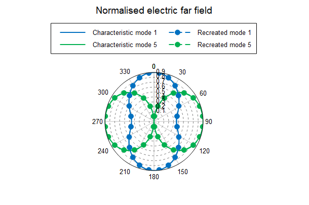

Compare the far fields of the characteristic modes configuration and the
reconstructed modes on a polar graph.
Figure 5. Comparison of the electric fields for the characteristic modes with the reconstructed modes.Note: Results are normalised in the comparison due to a lack of sources.The manually excited electric fields are in excellent agreement with the electric fields from the characteristic modes.
