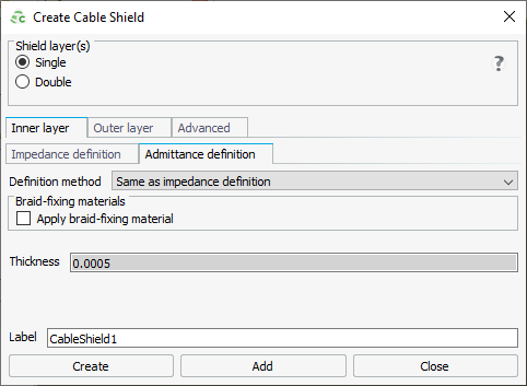

On the Inner layer tab, on the Admittance
definition tab, select Same as impedance
definition, from the Definition methoddrop-down list to use the Vance, Tynior Demoulin formulation for the admittance matrix.
Figure 2. The Create Cable Shield dialog.
Note:
The weave and filaments values are used from the impedance definition to
calculate the admittance matrix.
