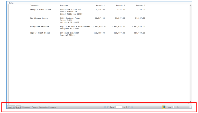

Toggle Maximized Mode |
Switches the view to maximized mode to enable viewing of wide documents. In this case, all of the tools located on top of the window move to the bottom of the screen.

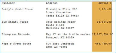

Add Dynamic Guide |
Adds a dynamic guide to the report. Dynamic guides help track alignment while reviewing the report and altering the stretch factor. To apply, click on a specific point in a single line to specify where the guide should begin and then drag your mouse until the entire area to be tracked is highlighted. Right-click on your mouse and then select "Add Dynamic Guide." In the figure below, for example, the dynamic guide clearly indicates an alignment issue in the report.

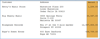

The figure below displays when the correct stretch factor has been applied.
