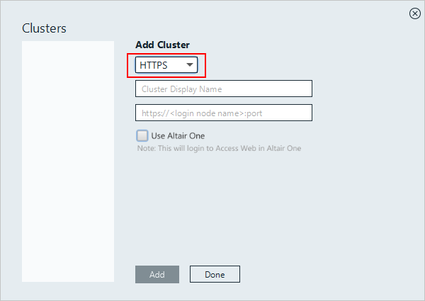

  5. Select HTTPS from the drop-down list.
    Adding a Cluster
    Figure 2. Adding a Cluster

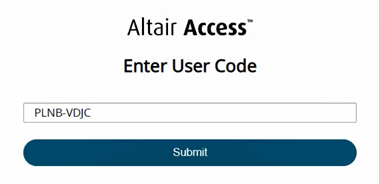

    A new web browser is launched and authenticates the user using the OpenID Connect (OIDC) and provides an authenticate code.
    OIDC Authentication
    Figure 3. OIDC Authentication to Altair Access
  9. Click Submit.

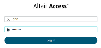

  10. Enter your credentials.
    Access Web Login
    Figure 4. Access Web Login
  11. Click Log In.

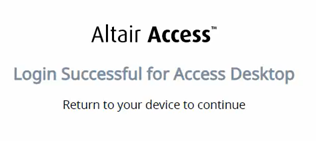

    Successful Login
    Figure 5. Successful Login to Access

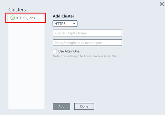

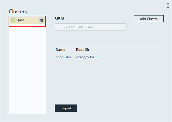

  12. Close the browser. Return to the Access Desktop application; the cluster is added, and a green check mark is displayed next to the cluster name.
    Figure 6. HTTPS Cluster Registered to Access

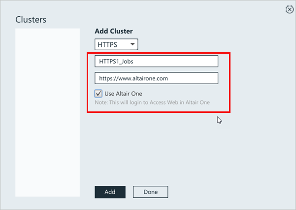

  7. Enter the Altair One URL https://www.altairone.com and select the Use Altair One checkbox.
    Figure 8. Connect to Altair One Server
  8. Click Add.

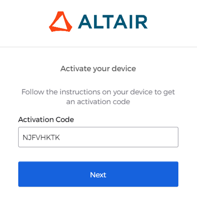

    Figure 9. OIDC Authentication to Altair One
  9. Click Next.

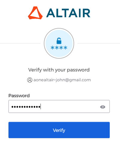

  10. Enter your Altair One login credentials.
    Figure 10. Altair One Credentials

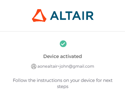

  11. Click Verify.
    The device is connected and activated.
    Figure 11. Successful Login to Altair One
