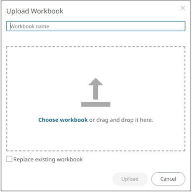

The Upload Workbook dialog displays.
2.     To upload a workbook, you can either:
·         drag it from your desktop and drop on the dialog, or
·         click Choose Workbook and select one on the Open dialog that displays.

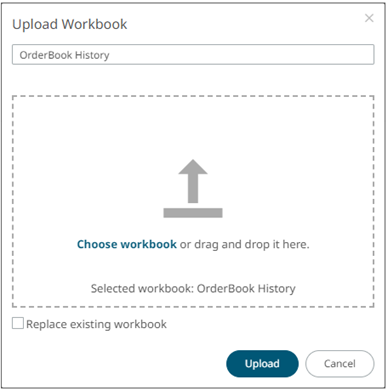

The name of the workbook is displayed on the uploaded workbook area and in the Name box.
3.     You can opt to rename the workbook.
4.     To replace an existing workbook, check the Replace existing workbook box.

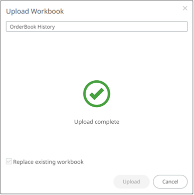

5.     Click .
You will be notified once the workbook is uploaded.
The workbook is added and displayed.
