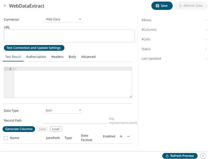

1.     On the New Data Extract page, select Web Data in the Connector drop-down list.
2.     Enter the absolute URL of the web data including scheme (HTTP/HTTPS) into the URL field.

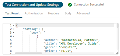

3.     Click . A successful connection will result to the following:
·         The Connection Successful status is displayed along with some raw data returned by the server.
·         Connector tries auto discovery of the Message Type.

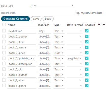

You can also opt to load or save a copy of the column definition.

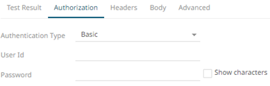

4.     Adjust the Authentication Type, if required.
4.1..    Select the Authorization tab.
4.2.       Set the required settings:
Authentication Type
None
No authentication needed.
Basic
Enter the User ID and Password to connect to the connector’s service.
Select the Show Characters box to display the entered characters.

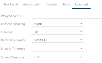

7.     Set the Advanced settings, if needed.
7.1.   Select the Advanced tab.
7.2.    Set the required settings:
Property
Proxy Server URI
The HTTP Proxy setting that will allow the connector to reach the endpoint.
Content Encoding
Select the Content Encoding with the HTTP Header: None, GZip, Deflate, or GZip and Deflate
Timeout
The length of time to wait for the server response (10 to 300). Default is 10.
Decimal Separator
Select either the dot (.) or comma (,) as the decimal separator.
