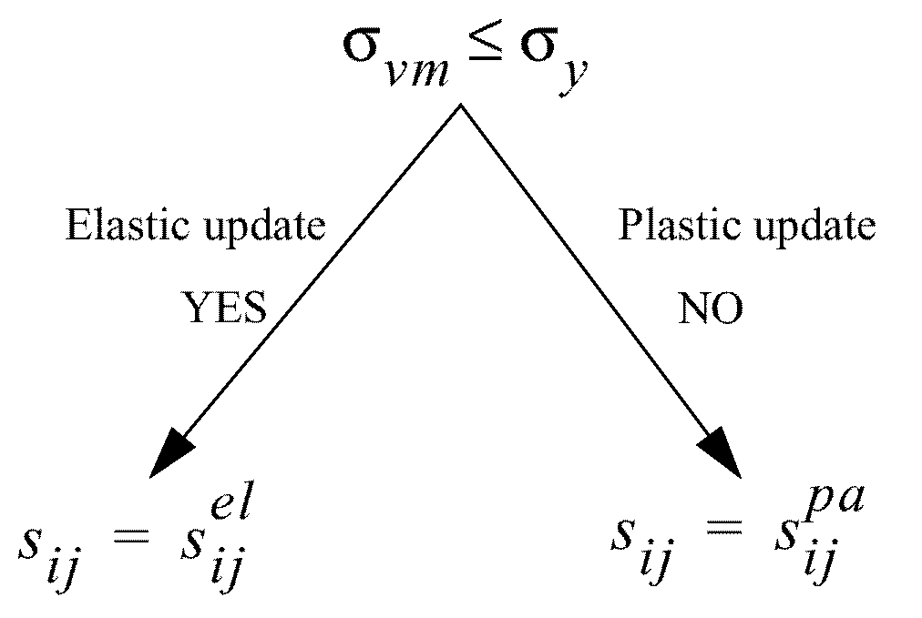

Plasticity Check
The state of the deformation must be checked.(4)
If this equation is satisfied, the state of stress is elastic. Otherwise, the flow stress
has been exceeded and a plasticity rule must be used (Figure 1). Figure 1. Plasticity Check
The plasticity algorithm used is due to Mendelson. 1

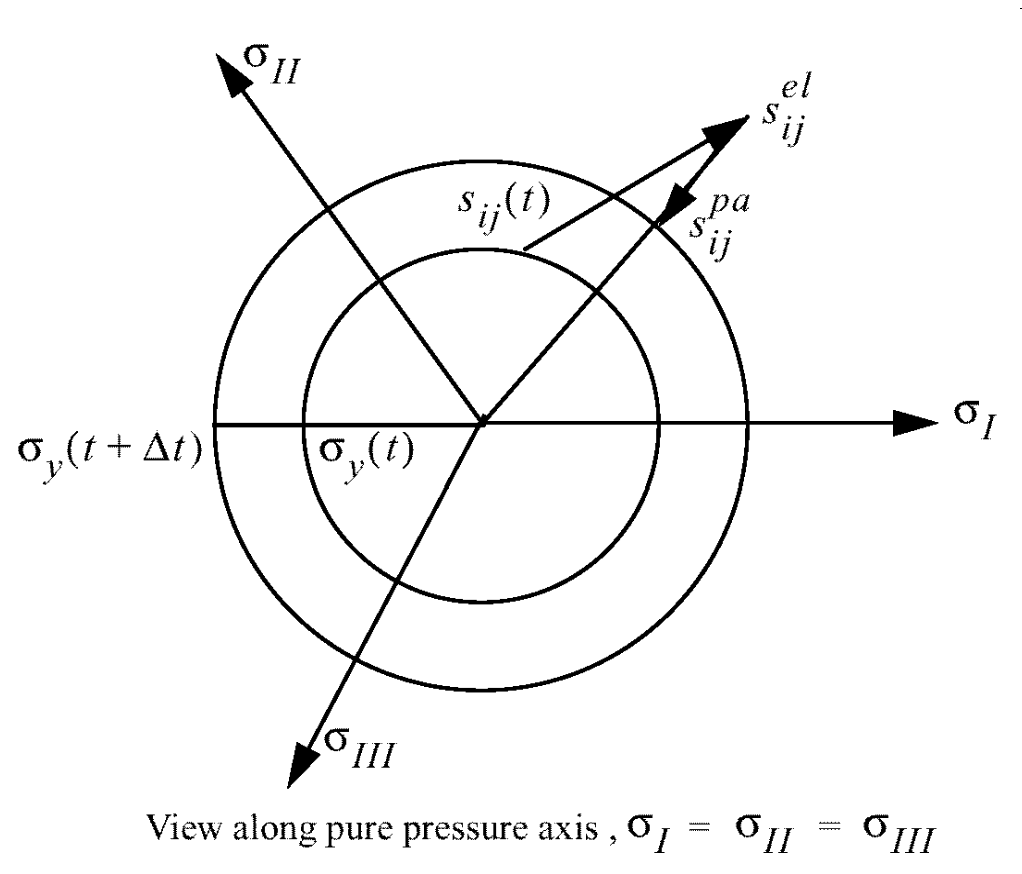

Radial Return
There are many possible methods for obtaining from the trial stress. The most popular method involves a
simple projection to the nearest point on the flow surface, which results in the radial
return method.
The radial return calculation is given in Equation 9. Figure 2 is a graphic representation of radial return.(9)
Figure 2. Radial Return
