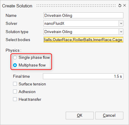

Drivetrain Oiling
![](../../images/nfx/icon_simlab_drivetrain_oiling.png)
![](../../images/nfx/create_solution_dialog_drivetrain_oiling.png)
In this solution, physics can be solved based on single-phase or multiphase flow.

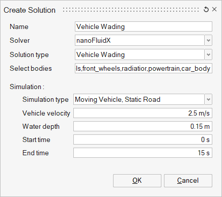

Vehicle Wading
![](../../images/nfx/icon_simlab_vehicle_wading.png)
This solution is designed for simulation vehicle wading through deep water. Two approaches are available for simulation type, Moving Vehicle/Static Road and Static Vehicle/Moving Road. These simulations are characterized by complex geometry interacting with a free surface fluid. Vehicle wading simulations in nanoFluidX are always single-phase simulations.
![](../../images/nfx/create_solution_dialog_vehicle_wading.png)
- Moving Vehicle [Moving Vehicle, Static Road]
- This approach mimics a real-world condition. A water channel is defined, and the vehicle drives through it. This approach is more realistic and captures the dynamic fluid behavior during water entry and exit. It is recommended for comparing physical tests. However, it is the more computationally expensive approach.
- This approach is simpler and uses a configuration like a wind tunnel. The vehicle remains static, but the road and wheels are assigned boundary conditions that mimic the correct vehicle speed. Water approaches the vehicle from an inlet at the front of the channel. This approach is less computationally expensive than the moving vehicle simulation, but it is not possible to capture the fluid behavior during water entry and exit.

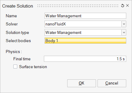

Water Management
![](../../images/nfx/icon_simlab_water_management.png)
![](../../images/nfx/create_solution_dialog_water_management.png)

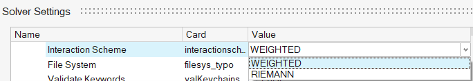

- Interaction Scheme
- In Solver Settings you can choose whether to use Riemann or Weighted interaction schemes (interactionscheme). Weighted is the default choice and is capable of handling violent and chaotic multiphase flows. Riemann results in smoother pressure gradients and less breakup of sprays and jets but will experience local instabilities with more violent flows.

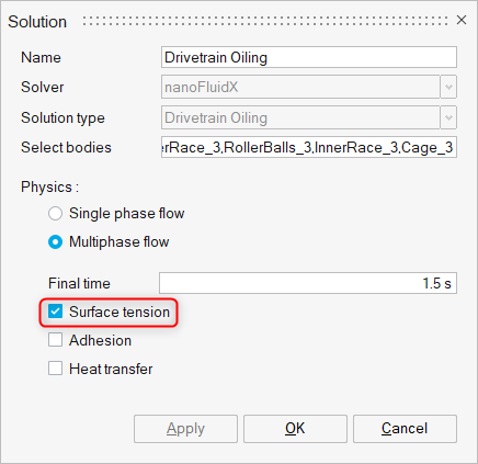

- Surface Tension
- Choose if surface tension is active (surften_model) and which model to use. By default, surface tension is disabled, since it adds computational cost.
