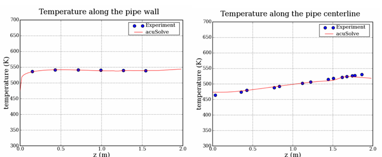

![](../../images/acusolve/temperature_along_pipe.png)
Figure 3. Temperature Values for Varying Streamwise Distance Compared to Experimental Data
Summary
The AcuSolve solution compares well with experimental results for two-phase nucleate boiling simulations. In this application, the temperature of the wall as the onset of boiling approaches are simulated with AcuSolve using the nucleate boiling feature and the SA turbulence model. The experimental values of temperature are presented with the corresponding AcuSolve results. A good agreement of simulation results with the experiment validates the ability to solve two-phase nucleate boiling using the nucleate boiling capabilities of AcuSolve.
