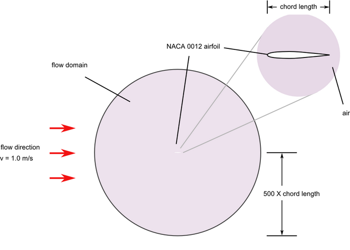

Problem Description
![](../../images/acusolve/turbulent_flow_over_a_naca_airfoilf1.png)
Figure 1. Critical Dimensions and Parameters for Simulating Turbulent Flow over a NACA 0012 Airfoil

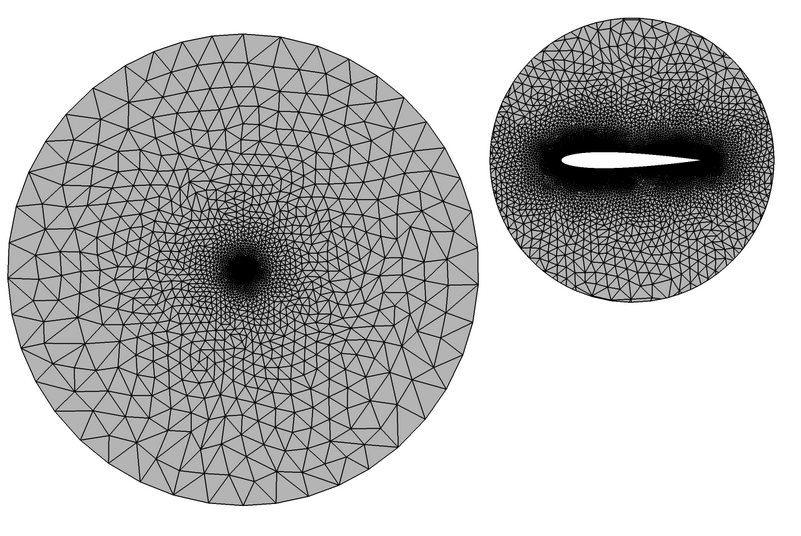

Figure 2. Mesh Used for Simulating Turbulent Flow over a NACA 0012 Airfoil (the Image on the Left Represents the Full Mesh, the Image on the Right Represents Mesh Details near the Airfoil)

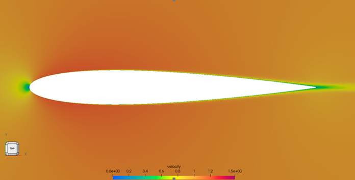

Figure 3. Contours of Velocity Magnitude Where Angle of Attack = 0 Degrees

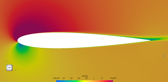

Figure 4. Contours of Velocity Magnitude Where Angle of Attack = 10 degrees

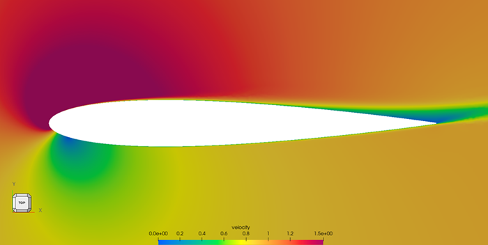

Figure 5. Contours of Velocity Magnitude Where Angle of Attack = 15 Degrees

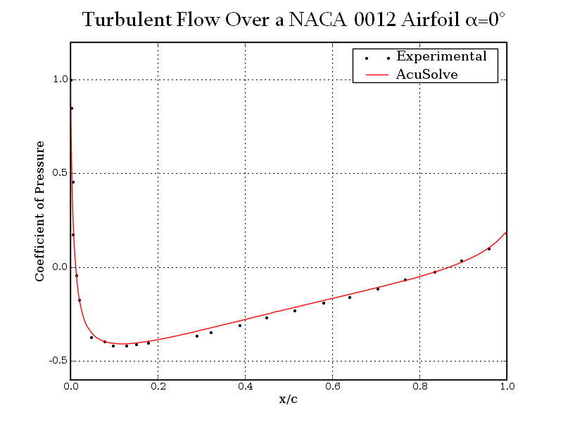

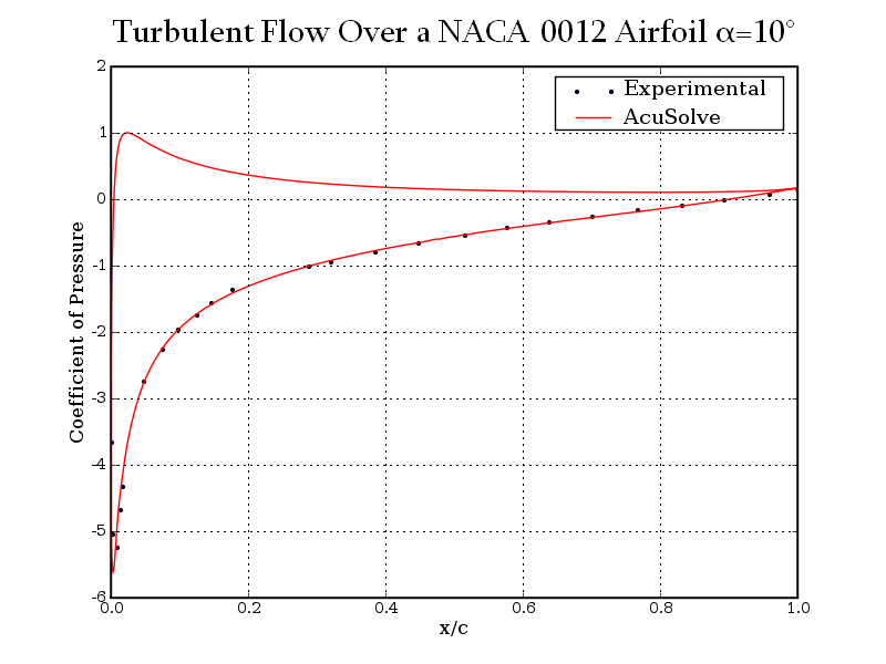

AcuSolve values for coefficient of pressure are plotted against experimental results for angles of attack (α) of 0 degrees, 10 degrees, and 15 degrees in the following plots. The results are presented for normalized distance along the airfoil, given by x/c, where x is the distance from the leading edge and c is the chord length.
![](../../images/acusolve/turbulent_flow_over_a_naca_airfoilf6.png)
Figure 6. Coefficient of Pressure Plotted Against Normalized Distance Along the Airfoil for Angle of Attack (α) = 0 Degrees

Figure 7. Coefficient of Pressure Plotted Against Normalized Distance Along the Airfoil For Angle of Attack (α) = 10 Degrees
