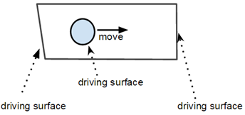

- interpolated_motion
- Nodes move based on the motion of interpolated motion surfaces. Requires interpolated_motion_surfaces.

- interpolated_motion_surfaces (list) [={}]
- List of surfaces whose motions are used to scale the displacements of mesh nodes in between. Each surface is defined by one instance of the INTERPOLATED_MOTION_SURFACE command.

For each node in the "Fluid" element set, AcuSolve computes the distance to the interpolated_motion_surfaces and scales its displacement based on the motions of the surfaces. This type of mesh motion is used in place of the ALE approach, or as a complement to it, to achieve mesh deformation in applications such as Fluid Structure Interaction. This is a rather simple method for deforming the mesh that has significant run time savings over using the ALE approach. Because of its simplicity, however, the method is limited in the extent of deformation that it can handle. More importantly, the motion of the mesh on every interpolated_motion_surfaces must be fully specified in all three directions. Consequently, free surfaces and guide surfaces cannot be used as interpolated motion surfaces.
![](../../images/acusolve/mesh_motion_acusolve_com_reff23.png)
In this example, nodes on the top or bottom surface are dominated by the interpolated mesh motion. If you want to constrain them within the planar surface where they are located initially, you have to put a slip-type simple boundary condition for mesh displacement or a zero nodal boundary condition for the component that is normal to the planar surface.
Another scenario is that both top and bottom surfaces are included in the driving surfaces as well. In that case you need to specify the motion of these two surfaces. If any component of the mesh displacement is missing, AcuSolve will just keep that component as its initial value. For example, you may set slip for the mesh displacement on the top surface, but you will not see any sliding motion of the nodes because interpolated mesh motion does nothing on nodes on interpolated_motion_surfaces or say driving surfaces. For the same reason, if you do not specify any mesh boundary condition for the top or bottom surface nodes there will just stay where they are initially throughout the simulation.
