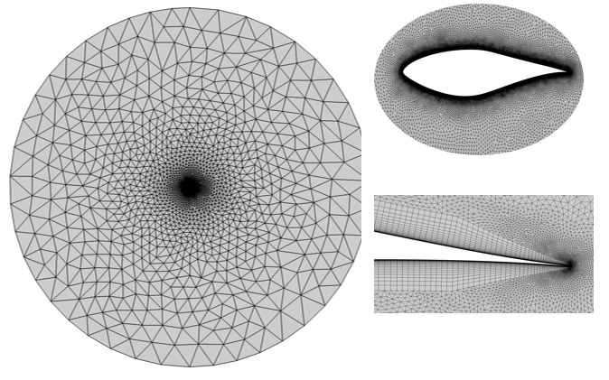

Figure 2. Mesh Used for Simulating Transitional over the S809 Airfoil
The simulation was performed as a two-dimensional problem by constructing a volume mesh that contains a single layer of elements extruded in the cross-stream direction, normal to the flow plane and by imposing symmetry boundary conditions on the extruded planes. The airfoil walls are specified as no-slip and the inlet velocity and eddy viscosity are specified at the farfield boundary.
