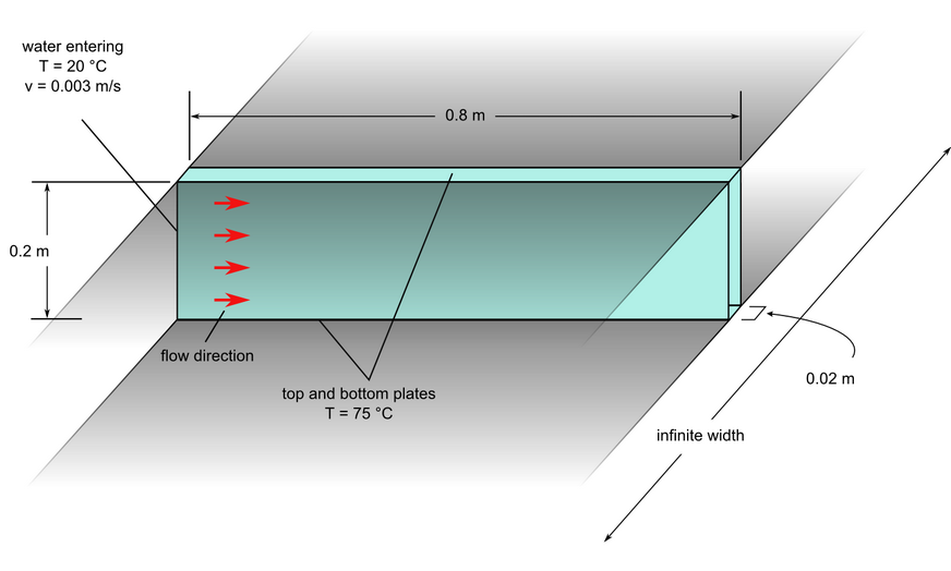

Problem Description
The problem consists of water at 20 °C flowing through a channel of infinite width with top and
bottom walls heated to 75 °C. The channel is 0.2 m high and 0.8 m long, as shown in
the following image, which is not drawn to scale. A centrally located slice 0.02 m
wide is modeled with slip boundary conditions so that side-wall influences can be
ignored. Water enters the channel with an average velocity of 0.003 m/s. As the
fluid flows through the channel, it is heated by the top and bottom plates. Figure 1. Critical Dimensions and Parameters for Simulating Laminar Flow Through a
Channel with Heated Walls

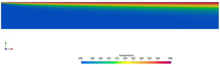

AcuSolve Results
The AcuSolve solution converged to a steady state and the results
reflect the mean flow conditions. As the cool water enters the channel at
temperature less than that of the walls, heat is transferred to the water by
conduction. As the fluid travels along the channel, the temperature differential
between the wall and the adjacent water decreases. The thermal boundary layer within
the water develops as the flow propagates downstream. Figure 3. Temperature Contours Along the Top Half of a Heated Channel

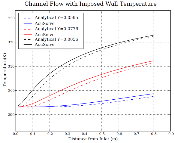

Temperature at a specified vertical position in the channel increases along the length of the
channel. The nature of that temperature change is dependent on proximity to the
heated wall. Water in the center of the flow will have the least temperature change.
Since this problem was solved for symmetrical flow, only the top half of the flow
region was modeled. The vertical position for results shown in the following figure
are based on the center of flow having a Y-position of 0. Figure 4. Temperature Plotted Against Distance from Inlet for 3 Different Heights
from the Channel Center Line
Summary
The AcuSolve results compare well with the analytical
results for the development of a thermal boundary layer in a heated channel. In this
application, the model is set up to yield large gradients as the flow convects away
from the inlet. The boundary conditions and mesh size were chosen specifically to
yield a high Peclet number. The element Peclet number in the flow direction in this
case is Pe=30.0, as calculated from the following equation.
