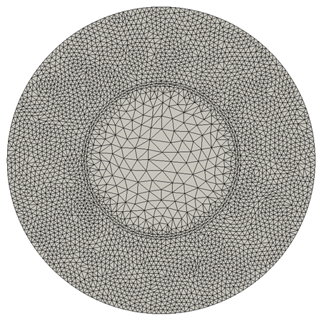

![](../../images/acusolve/flow_between_concentric_split_cylindersf2.png)
Figure 2. Mesh Used for Simulating Flow Between Two Concentric Cylinders
The simulation was performed as a two dimensional problem by constructing a volume mesh that contains a single layer of elements in the extruded direction, normal to the flow plane and by imposing slip flow and mesh boundary conditions on the extruded planes.

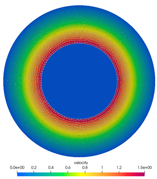

![](../../images/acusolve/flow_between_concentric_split_cylindersf3.png)
Figure 3. Contours and Vectors of Velocity Between the Concentric Cylinders

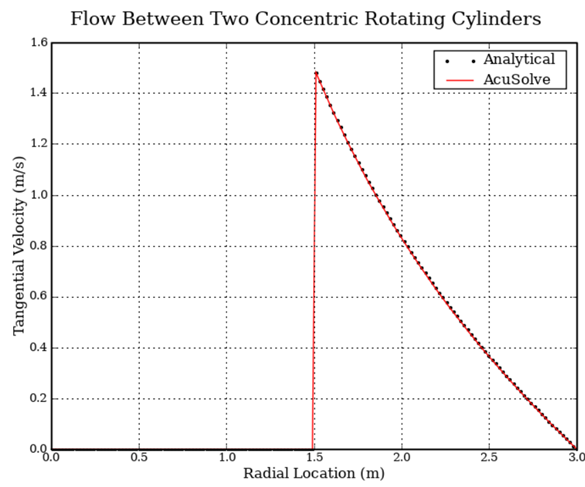

![](../../images/acusolve/flow_between_concentric_split_cylindersf4.png)
Figure 4. Tangential Velocity Within the Solid and Fluid as a Function of Radial Distance from the Center at the Final Timestep
Summary
The AcuSolve solution compares well with analytical results for laminar flow between concentric cylinders, where the inner cylinder guides the adjacent fluid elements. In this application, a fluid initially at rest inherits the angular velocity from the inner cylinder while the outer cylinder does not rotate. As a result of the inherited velocity and viscosity of the fluid, flow develops between the two cylinders. The AcuSolve solution for the tangential velocity as a function of radius matches exactly with the analytical results.
