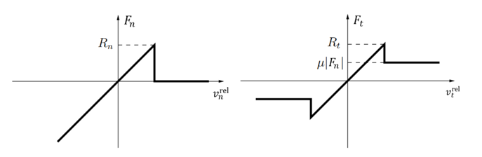

The model yields the following force-displacement behavior:

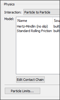

To use the Linear Elastic Bonding Model, you must first add it to the Physics of a given EDEM simulation and then configure as required.

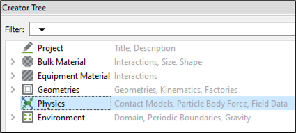

  1. In the Creator Tree, select Physics
  2. Select Particle to Particle and/or Particle to Geometry from the Interaction dropdown list.

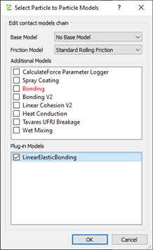

  3. Click Edit Contact Chain at the lower section of the Physics panel.
  4. Select No Base Model from the Base Model dropdown list.
  5. Under Plug-in Models,  select the LinearElasticBonding checkbox.
  6. Click OK.

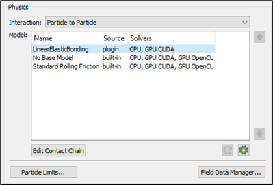

    The plug-in is displayed in the Model panel.

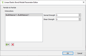

  7. Select the plug-in and click the  icon in the lower-right section of the Physics panel to configure it.
    The Linear Elastic Bond Model Parameter Editor is displayed.
    As long materials are defined in your simulation, the  icon will be enabled.

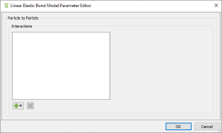

  8. Click the  icon to view a list of all possible interactions for Particle to Particle or Particle to Geometry contacts.
  9. Select the interaction you would like to set up bonds for.
    The dialog box displays two parameters on the right-hand side.
  10. Specify values for Normal Strength and Shear Strength of the formed bonds.
    To understand how these parameters determine the model behaviour, see the Theory section.
  11. Once you have entered values for the interaction, click OK and repeat the same steps for other interactions you would like to set up bonds for.
